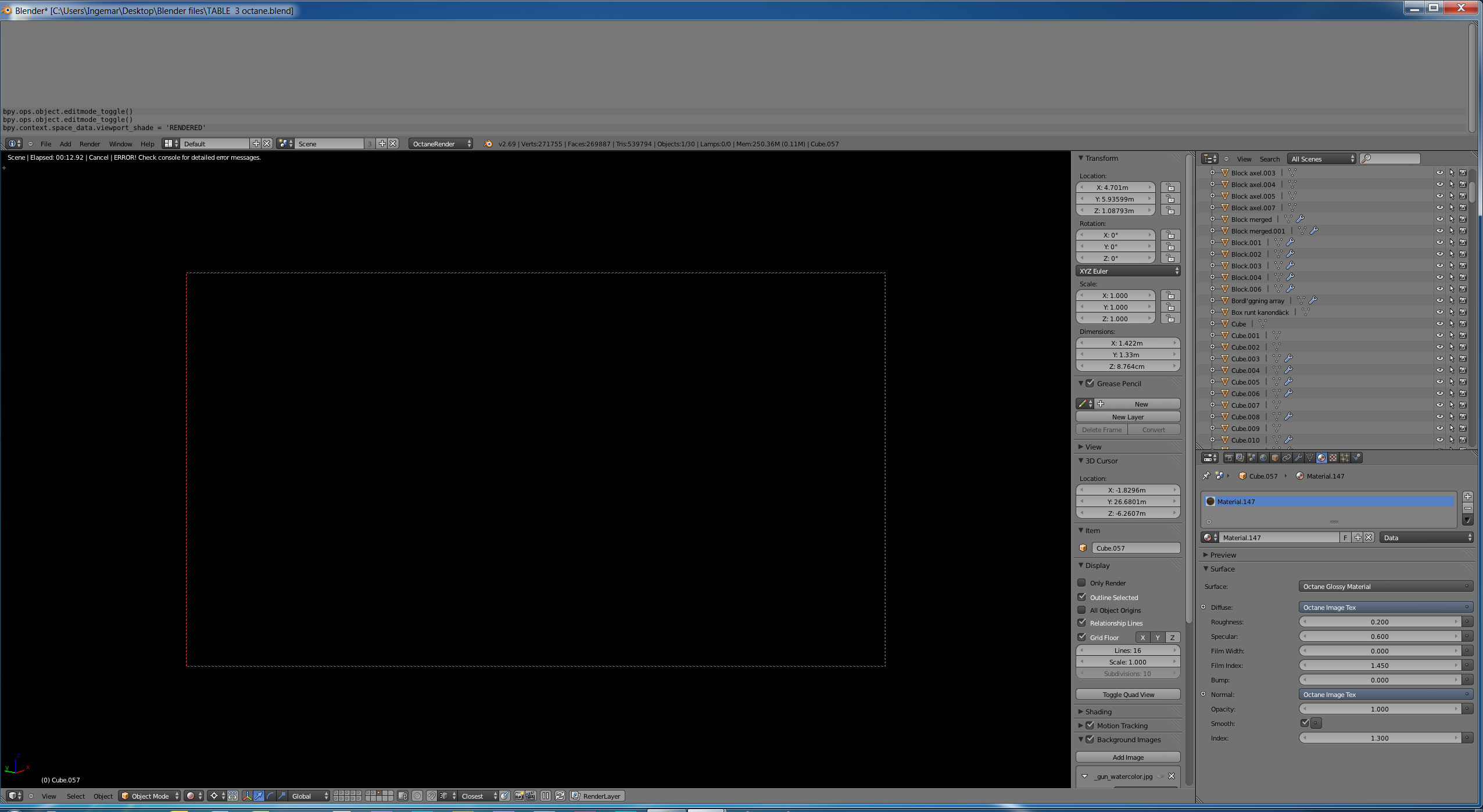

Using OctaneRender™ for Blender 1.27 - 3.1 beta Win. Quite often i get this message "Cancel Error check console for detailed error message". This happens when i click preview render every now and then. The viewport goes black after this. On 2nd try it often works again. Octane Server still running.
Now i have a more serious problem. I get the same error message but this time it refuses to render even after 10 re tries. have also tried F12 render. Loaded up a previous save and it works. Seems like my file is corrupt some how?. Luckyly i have the habbit of re-saving to new files so only a few hours of work lost.
Any idea what can cause this? It happens quite often when trying to preview render but usually works again on 2nd try. Judging by the slow display performance and the fan noise the GPU is running at full speed even though no rendering is happening. Driver 332.21 GPU Nvidia GTX Titan. Samll scene so not out of memory.
Where do i check the console? The blender console? No messages there.
Attaching screen dump.

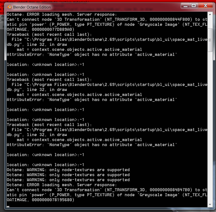

igor73 wrote:Where do i check the console? The blender console? No messages there.
It is impossible, Blender console always has some messages, it can't be empty. Can you please post here the content of that window?..
igor73
Posts: 84
Joined: Fri Jan 24, 2014 8:04 pm

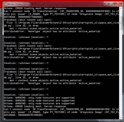

Here is the console message. What is the node"3D transformation" it reports about?
igor73
Posts: 84
Think i found the cause. I had accidentaly connected a full transform node in to the power input on a full float image tex. Removed it and it works again.
