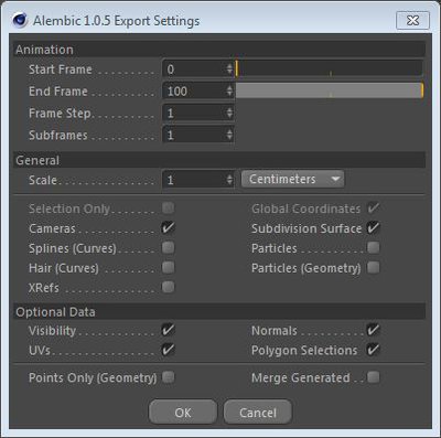

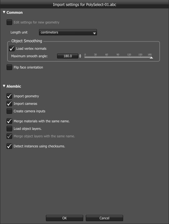

here is the screenshoots of the c4d and octane exporting/importing settings:

How you got "global coordinates" in your export c4d window, i don't have it.

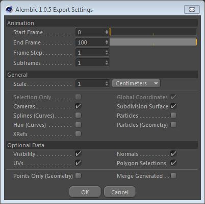

But sometimes, strange things happen. (it's a bug or something i do wrong ?)
The same exercice with mats to poly sélections correctly named.
- A cube with poly sélections.
- Others objects like two spheres
Result : only one link for one material and only one sphere, where is the other sphere ?
Thank you.
Niuq
ALEMBIC-TESTING.rar
(634.27 KiB) Downloaded 404 times
Posts: 10643
hi niuq,
very interesting, i think that you have found a very strange bug, all is exported correctly only if the cube with multy polygon selection tags is hided before to be exported inside the complete scene :roll:
if the muly poly-selection cube is exported separately with the "selection only" option enabled, it's exported correctly as expected :roll:
try to export my c4d file as it is and you will see the crazy result :D
the purple sphere is not visible because it's a primitive inside a nurb, you can dessble the hypernurb or make editable the sphere ;)
