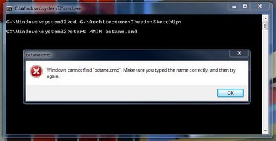

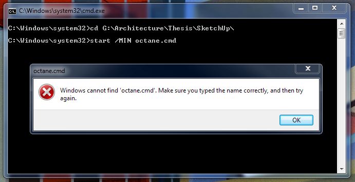

Hi TIG:
I'm still having problems with the cd in the command window:
This is with the 1022-11.
Mac Pro 3,1 / Lion / 14G RAM / ATI HD 2600 / nVidia GTX 470
i5-750 / Windows 7 Pro 64bit / 8G RAM / Quadro FX 580
Revit 2011, SketchUp 8, Rhino
timbarnes
Posts: 125
Joined: Thu May 20, 2010 1:56 am
Location: California
If I save the .obj/.mtl and then open them from within Octane it's OK, so those files are being created properly.
tim
TIG
Posts: 536
Joined: Wed May 12, 2010 1:25 pm
Perhaps your system is so fast that it hasn't "registered" the existence of the 'octane.cmd' file after it's made it, before making and running the 'start.cmd' file that is returning the message - I'll try adding a 'sleep' between making the two cmd files and running 'start.cmd'... It is making the files OK!?
