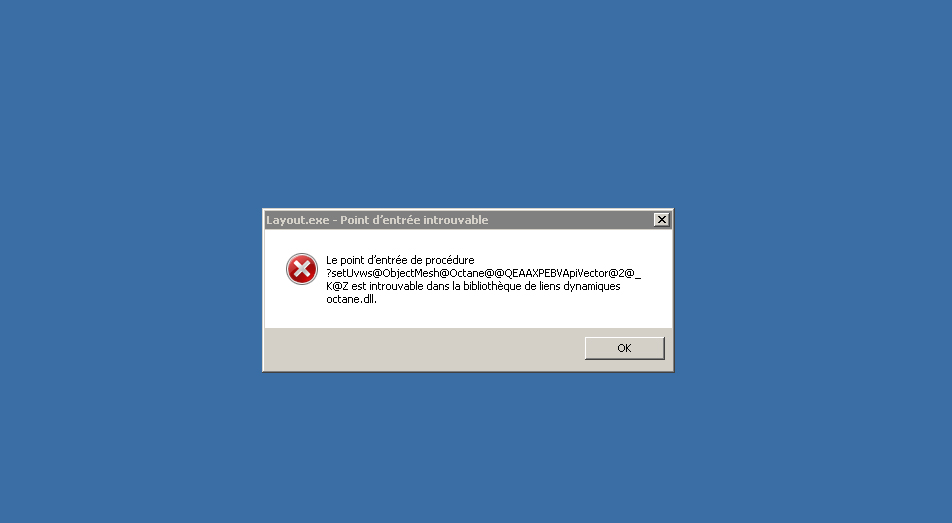

In the opening of LW, I have message. An idea?
LW 11.6.1
Octane 1.5 beta

You are mixing old Octane.dll/Octane.dat files with a newer plugin, or new .dlls with an old plugin.
Please, download the last 1.25.0 release .zip file and replace your .dll and the plugin files to be sure that all is updated.
