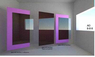

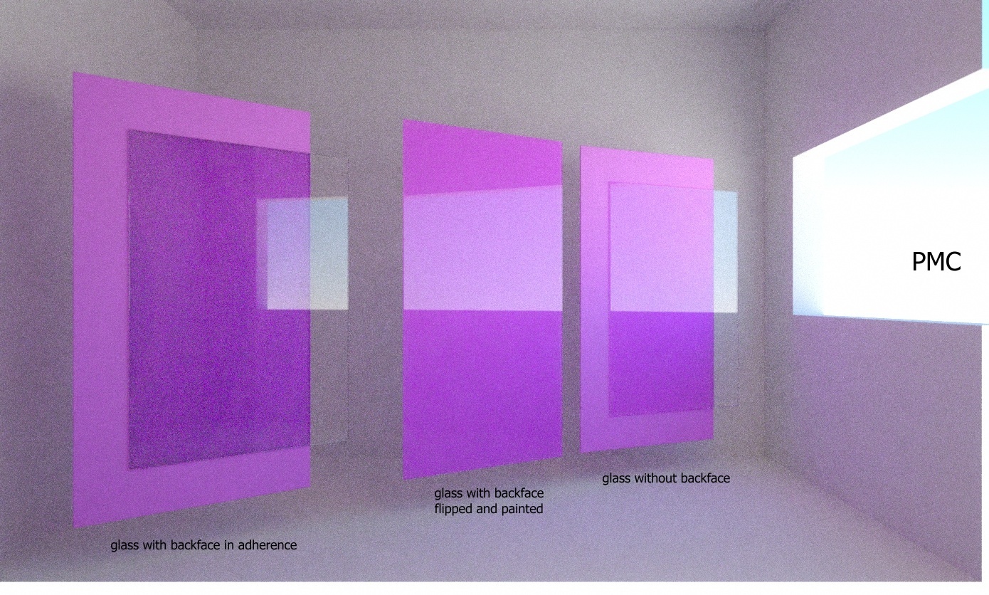

Hi to all (and excuse me for my terrible english)
Is there any way to make a good back painted glass with the AO kernel?
I did two test (see attachments) with AO and PMC.
Glass is standard specular material (with fake shadows on, but without is same)
I would like to have the same PMC result using the AO kernel.
Thanks for all :)

use "Diffuse" and not AO
Its looks for me a bitter like PT

You're right NVN
Infortunately Diffuse is slower than AO.
Also in this specific case the kernel Diffuse fails to illuminate the back of the glass

This is how ambient occlusion works, the whole backplane is ocluded by the glass plate so it's dark.

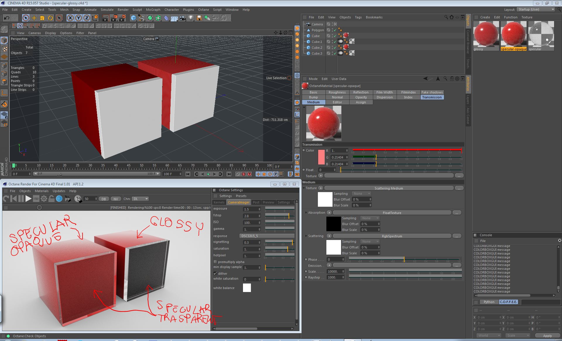

Posts: 10377
hi,
some time ago, marcus has solved the issue for the specular material with ao.
so if you use a specular material with sss for the back part, it works pretty well ;)
