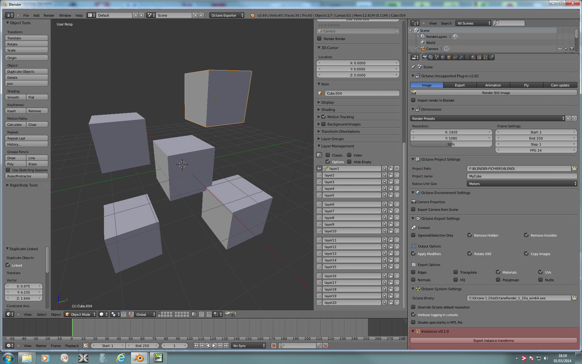

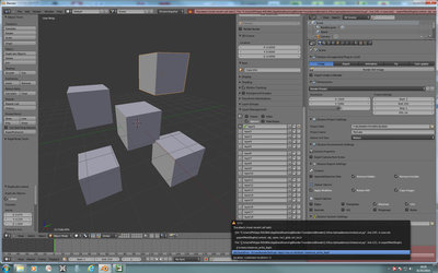

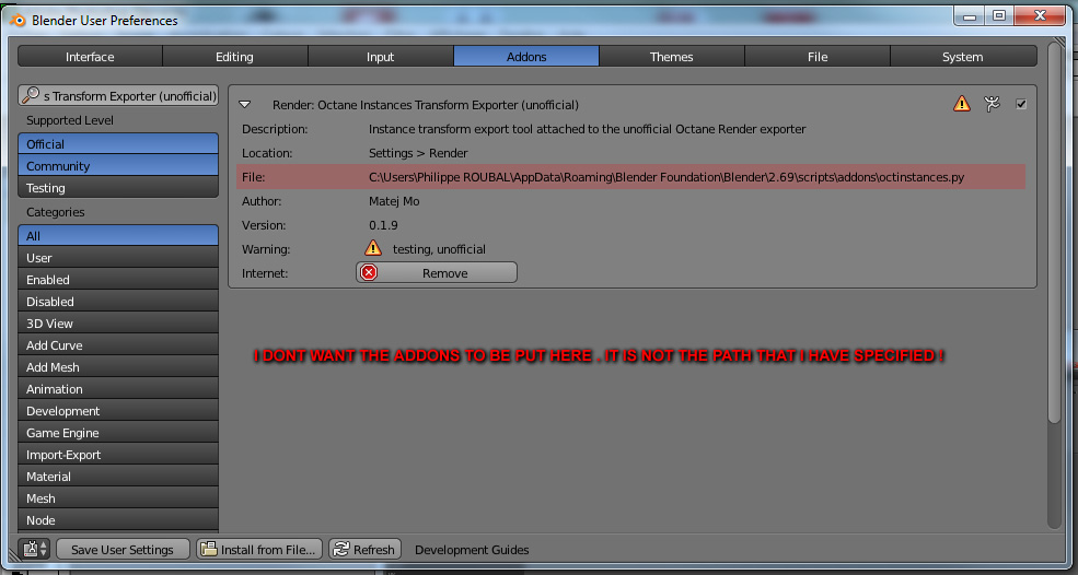

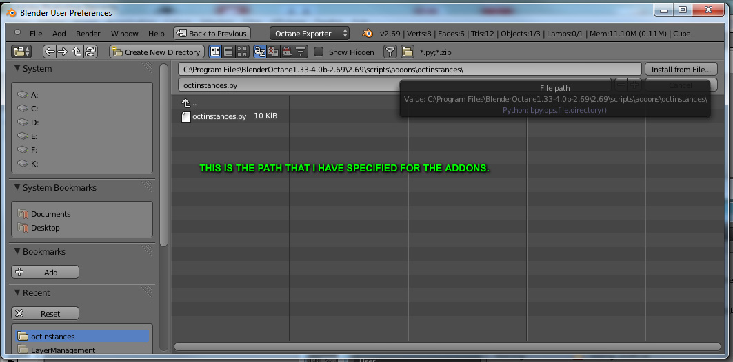

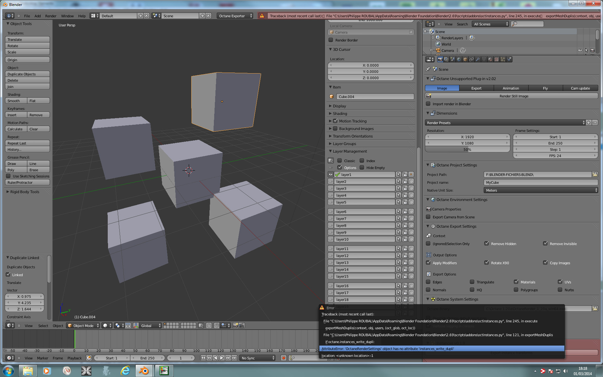

Well, bad news : I encounter the problem of the octinstances_v019 not working with the Blender 269 for Octane version. This instances exporter still works fine for me with the official Blender 2.69, but refuses absolutely to work with the plugin version.
I deinstalled and reinstalled everything many times : Blender 2.69 for Octane, the Octane Unsupported Plug-in v1.20 by Lionel (also tested with the more recent v2.02), and the unoffical Instances exporter octinstances_v019 by Matej.
I also deleted the content of the Blender roaming folder (copy of the python script) without any success. Blender for Octane choses itself the path and rewrites the folder content.
I can't export instances (csv files). The little plugin panel also doesn't show the Write dupli objects to file. This last point is not a problem for me as I never use this feature, but the main problem is that the script doesn't work at all.
The weirdest thing is that whatever path I type in the field, the python file isn't installed at the specified location, but instead in the Users\...\AppData/Roaming\... path.
