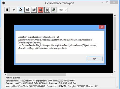

I got this error (below) today. But more worrying was the fact that the screen was black with no image.
Then, when I tried to navigate in the OVP (the viewport navigation was on by default), I got:
1.25.0.1 navigation crash
I could not get out of the plugin either. Had to stop Revit in the task manager.
I'm finally on my new system: Win 8, Revit 2014. I do not have the 1.2 plugin installed on this machine. Standalone version in 1.20.
Let me know should you need any more info.

Hendrik - I think that there is some old Octane 1.20 settings in the RVT file causing this. Perhaps it is the sun vector at 0, 0, 0 (which would throw an error such as this). Could you pls reload the RVT file, and check the sun settings in the Settings tab.
EDIT: Could also be the aperture or scale being out. If we can identify the cause, I can code the latest version to ensure this does not happen.
EDIT2: It might also be a 0, 0, 0 camera up vector.
