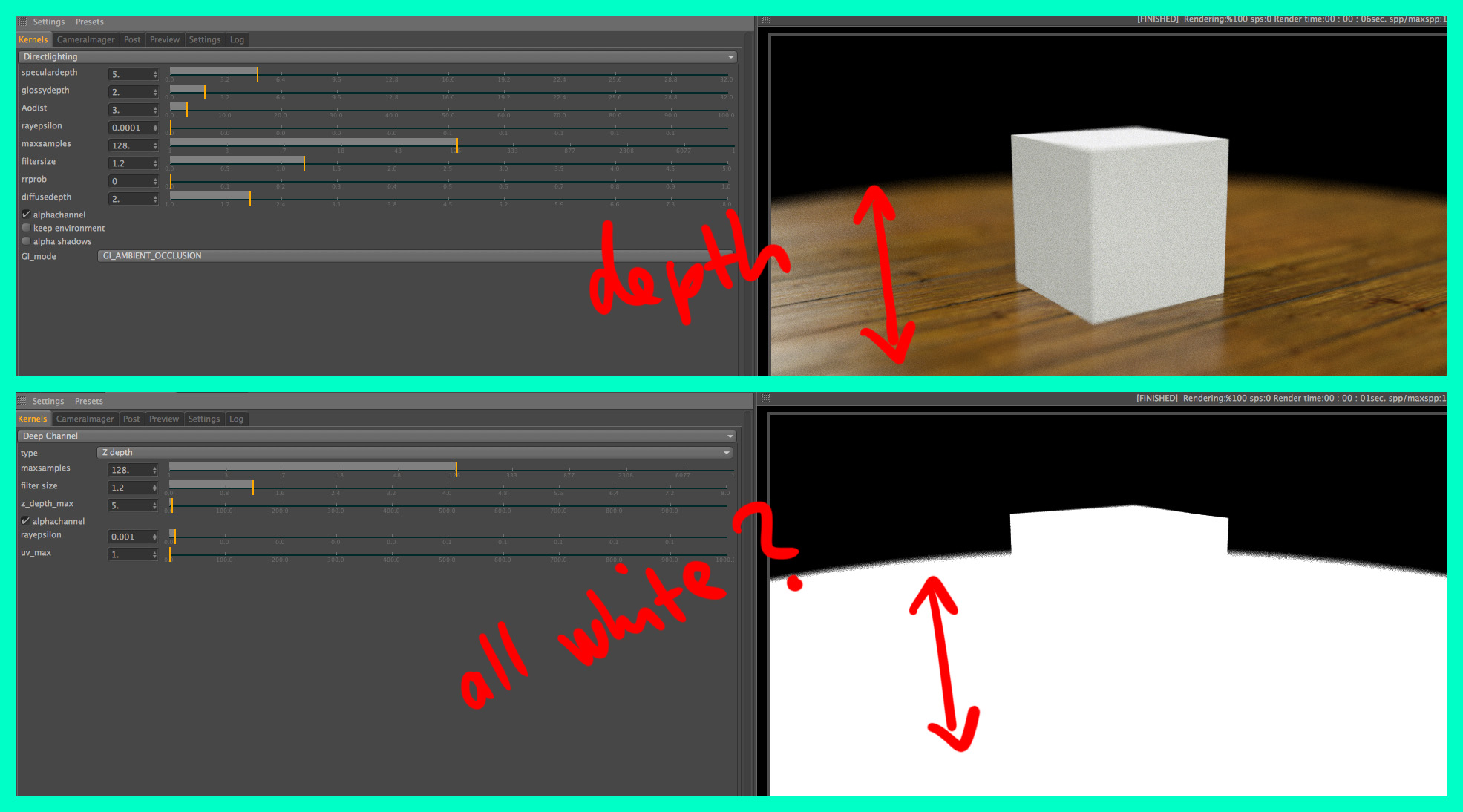

I am currently trying to understand the mulitpass workflow with Octane in C4D.
While testing the Z depth of the Deep Channel kernel, I ran into this problem (see attached image).
What am I doing wrong?
Thanks!
Deep Channel > Z depth > completely white?
z_depth_max is low
Thank you, sir!
