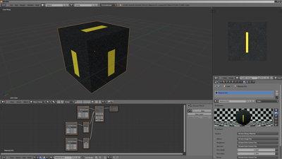

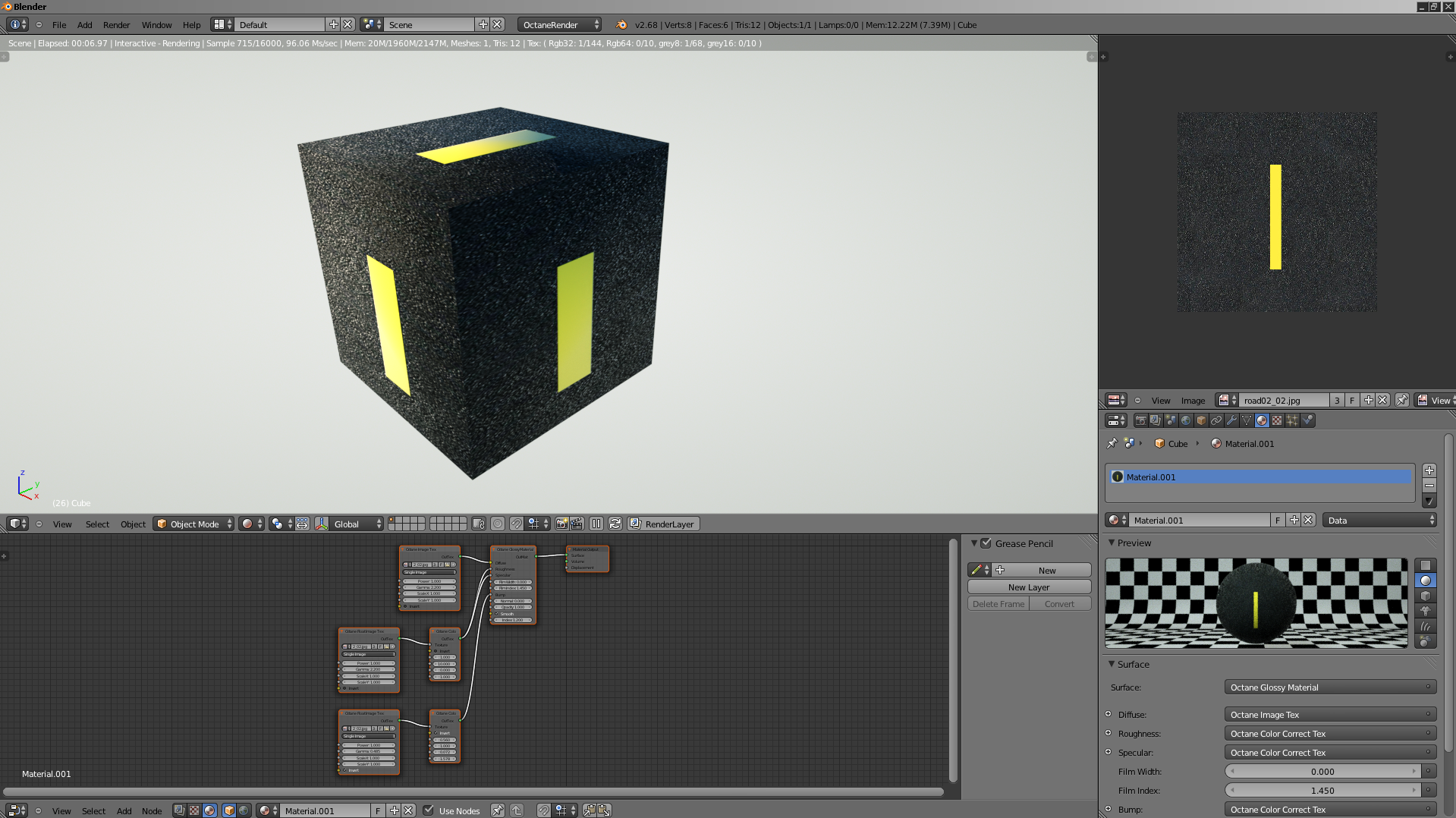

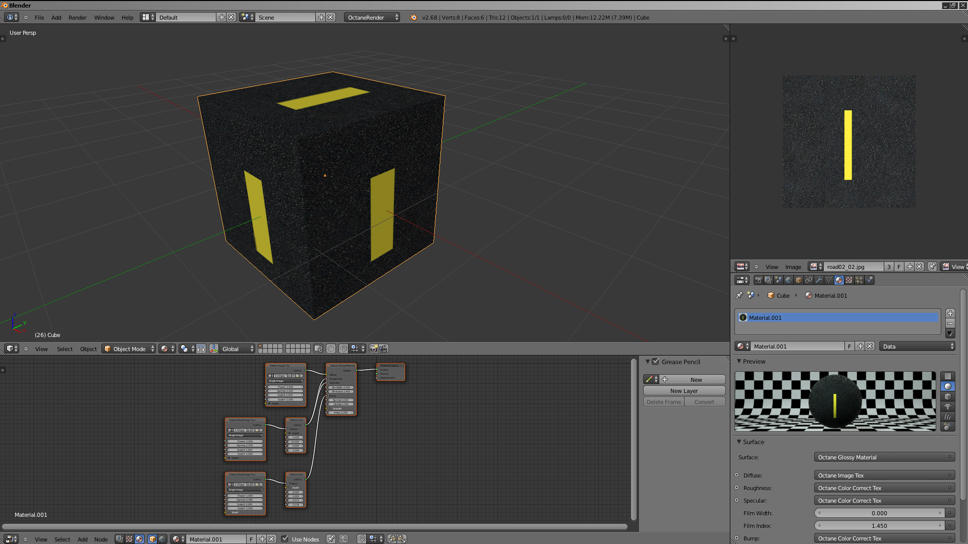

I think there's a problem with the blender octane image map rendering.
Images don't render.
https://www.dropbox.com/s/a7v9sxf2eqpco ... .25.22.png
https://www.dropbox.com/s/gf6eb8jp8y61x ... .28.35.png
it's very frustrating

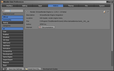

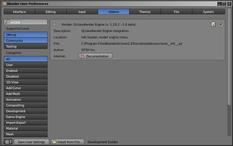

Hey guys
Ya, i know. Unwrap, install the plugin...ect...
Really i think it's a problem with the plugin.
For now i'll just export it into octane for the final texture rendering but it's just something that i think is worth taking into consideration.
Maybe mentioning it to Lionel, idk.
anyway, have a nice day. :)
