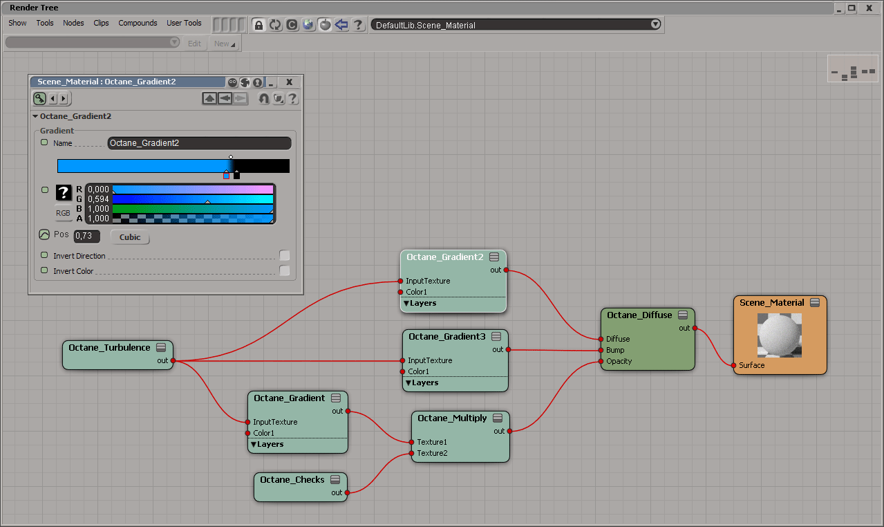

The gradient texture is now added and it´s possible to animate it.
For now it is only possible to use colors, but in the next stage it will be possible to use any texture as color.
Also some color presets are planed.
The render tree of the material in the video is shown below...

Also the new projection mappings are implemented and the gradient texture on which i´m working on.
With the gradient, you can also use the alpha color channel. For this i create an internal shader group, add two gradiens in it and use a mix node to mix between the input texture and the first gradient with the amount of the second alpha gradient.

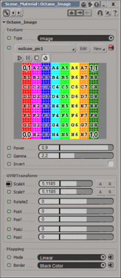

The first one is solved. the second one is on the list because i must rewrite it with the new mapping modes.PeterCGS wrote:Hey Face! Did you solve the "be able to animate camera aperture and environment rotation" problem?
The image node is also rewritten with the ability to look the aspect ratio, also the new mapping modes are implemented...
