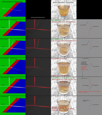

ior < 1 needed
bicket
Posts: 365
Joined: Thu Mar 01, 2012 10:46 am
please octane team check this.
un-biased, physically based renderer have to render the right way.
reply required.
Regards
PortFolio
4 x TITAN - Win 7 64 - Octane Rocks
roeland
Posts: 1823
The best way in current versions is the overlapping method. This will render correct refraction and absorption for both the glass and the liquid inside. Other than that the single surface method with inverted normal will work, but only for liquids without absorption.
The one labeled Octane "official" is definitely wrong, this tutorial may need an update. The behavior of overlapping volumes was changed in version 1.20.
Roeland
bicket
Posts: 365
Hi Roeland, thanks for your fast answer.
I agree with you for the 2 acceptable method (overlapping volumes and single surface with inverted normal), that's the conclusion of my test
BUT is there a plan in the next releases for a more robust solution :
- fixing the way absorption work with inverted normal => maxwell method and single surface method will become acceptable
- allowing ior < 1 => Octane ex-"official" method will become acceptable and pretty clean and fast
PortFolio
roeland
Posts: 1823
We can allow an IOR of less than 1.0, that would correspond to going from something with a high IOR to something with a low IOR.
Roeland
bicket
Posts: 365
roeland wrote:We can allow an IOR of less than 1.0, that would correspond to going from something with a high IOR to something with a low IOR.
Glass generally has a higher ior than liquid : it will be a good news for those who render Perfume bottles, Coffee, Tea , orange juice .... like me. ;) Cheers !

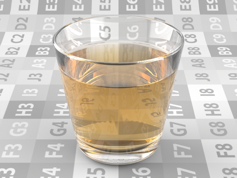

I think it's ok
