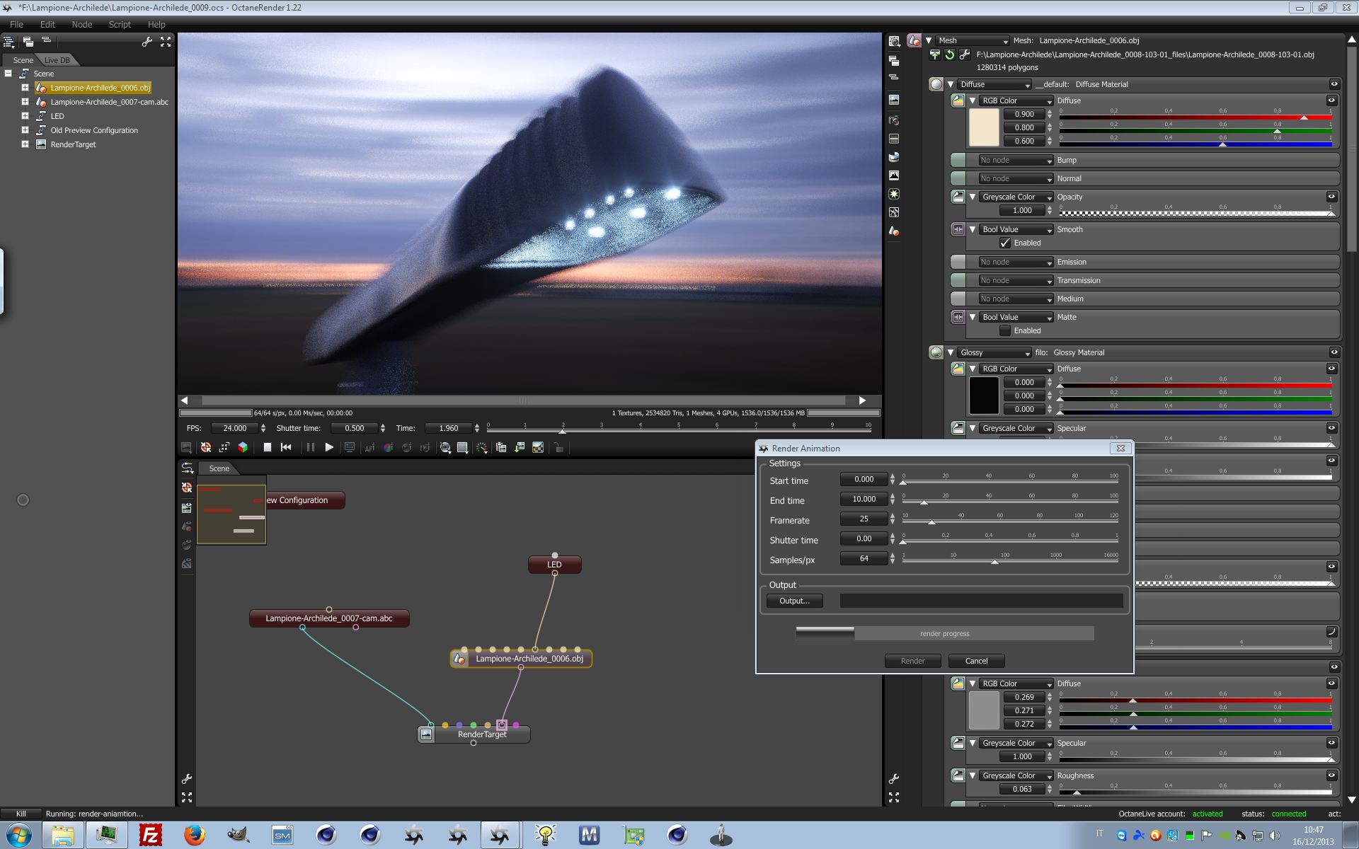

With the ability to import camera paths and rigid body animations via Alembic, we now can render the animation in Octane without having to open a new OCS file all the time. So we will now make a script rendering a basic animation.
Of course we don't have to start from scratch: the UI is similar to the turntable animation script here: http://render.otoy.com/forum/viewtopic.php?f=73&t=37313
I will highlight mostly the rendering parts.
The first step is inspecting the scene and figuring out what to render. we get the first render target in the scene, and also get the total length of the animation via the root node graph. We also set up some global state needed in the render callback.

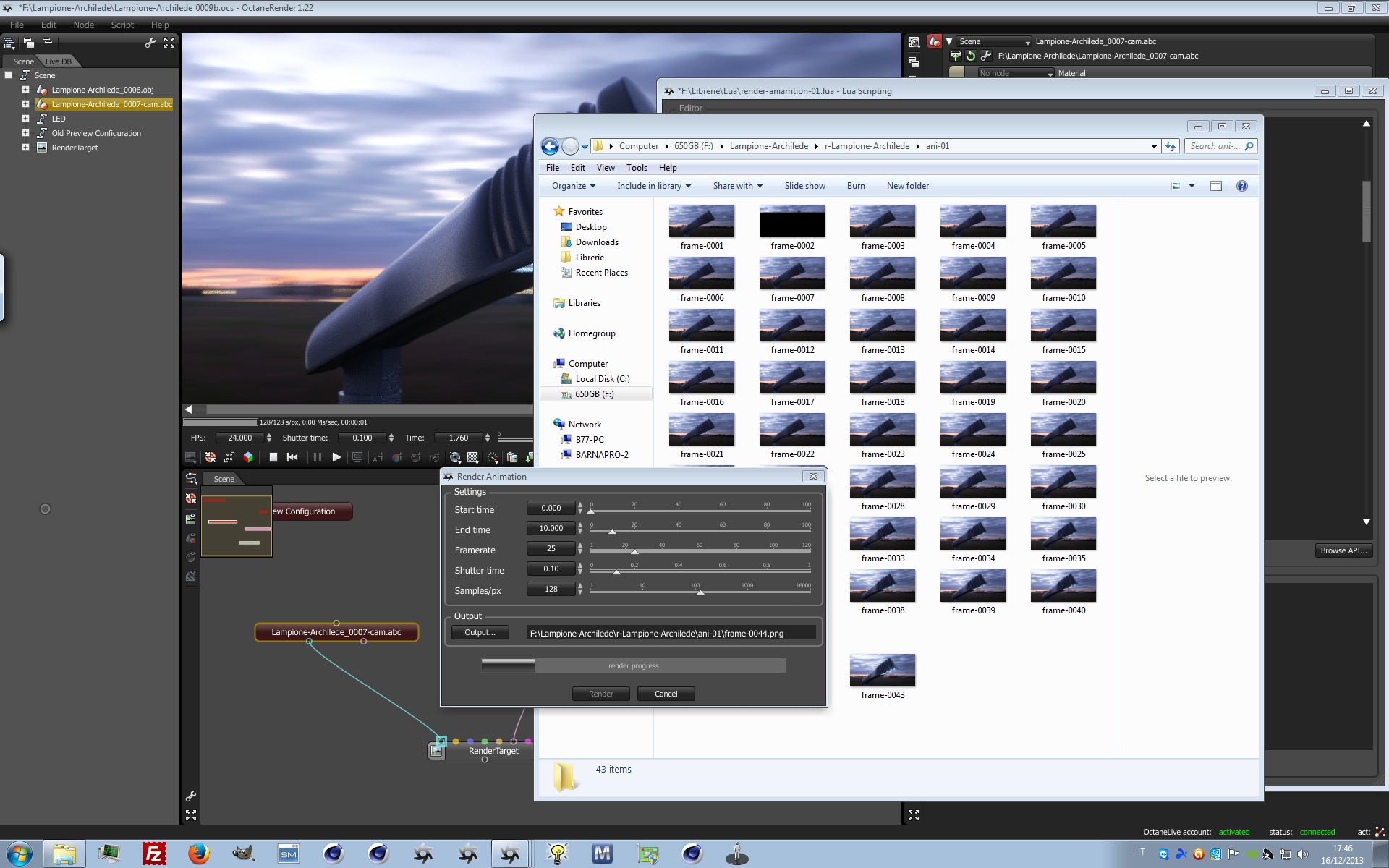

Then comes the render loop. We increment the current time stamp until we get to the end time set up via the sliders. Due to rounding errors, and because the end time is the last animated time stamp, we need to make sure this time stamp is also rendered, even if some small rounding errors occur.
For each frame we update the time stamp of the root graph. This automatically updates all animated attributes in the scene. Then we can call octane.render.start, which will block until the render is finished.
After rendering we check if the rendering is canceled, and if not we save the image if a file name was given. To give some feedback on what we are saving, we update the file text field.
Finally we increment the current time.

Most of the GUI code is very similar to the turntable animation script, so I'm not repeating it here. There are some different sliders, and some sliders and the file name text box are stored in global variables, so we can access them from the callbacks.
We still have to hook up callbacks to our buttons. We will also stop the render if the window is closed.

We can do some further improvements to this script. We still have to hook up the output... button and the shutter time slider. For now you can set the shutter time in the time line below the rendered image before you start the script.
A small downside of this script is that it modifies the scene. If you want to render multiple scenes in a batch, this will be a problem, because Octane displays a prompt to save changes before opening a new scene. To avoid this we can copy the root node graph to a temporary root graph created in the script, and render from this one.
But for now, here is the complete script.

Posts: 10641
wow, thanks roeland for this :)
the render and cancel buttons work very well, i was able to see and render a sequence with camera mb, fantastic :)
the only issue is that the "output" button doesn't work :(
shouldn't be an "exportToFile" somewhere in the script?
ciao beppe
Posts: 10641
sorry roeland, forgot my last post :)
after reading carefully your script, i have found this:
Code: Select all
 -- if the file name doesn't contain a sequence number, the match fails
so, i have understand that my mistake was to not specify the 0000 in the file name :)
thanks again, i was able to save my first alembic animation with camera mb :D
ciao beppe
