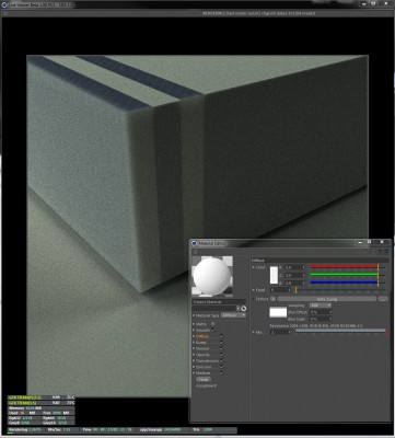

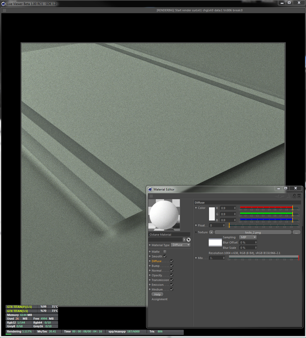

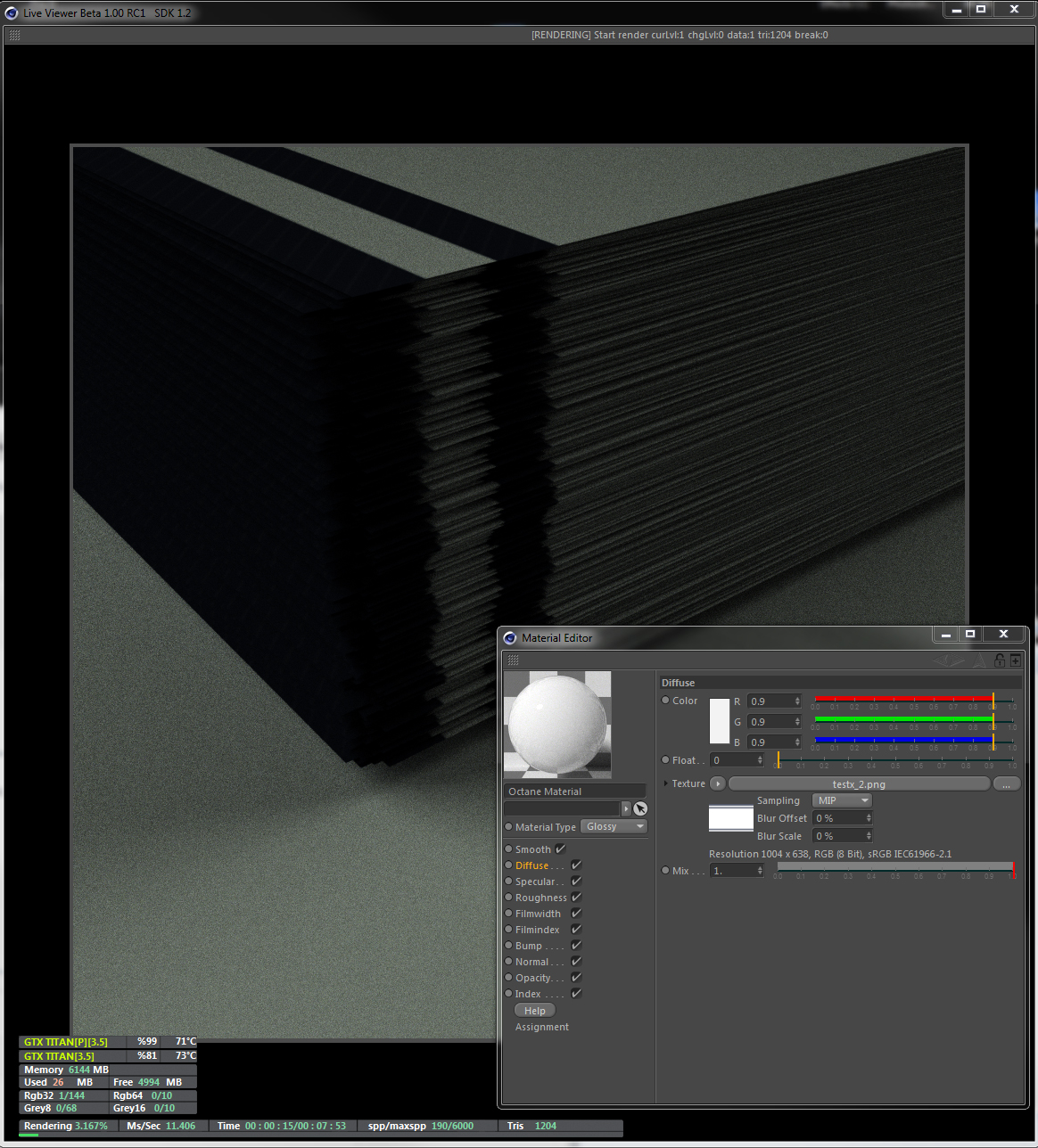

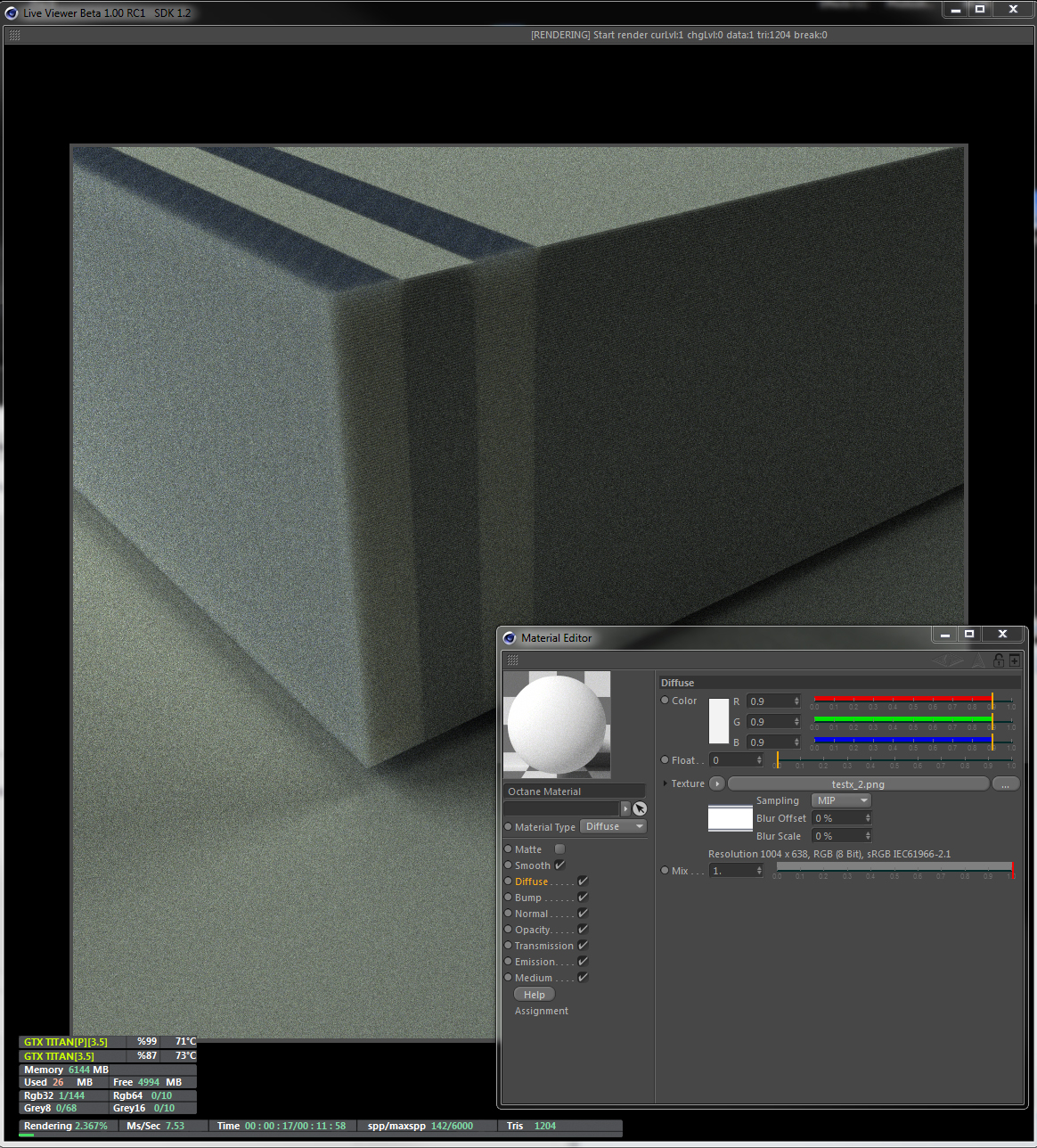

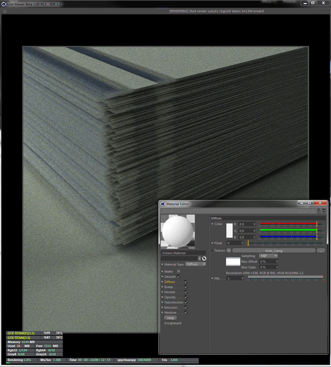

Hi, Im getting problems with this scene, please open it and see what happens.
1. when the cloner is active and effector(random) is active, the material is diffuse I have an error because the texture is displaced.
2. when the cloner is active and effector is active, the material is glossy the texture is right placed
3. when the cloner is active and effector inactive, in diffuse mode, the texture is misplaced.. (in glossy mode is ok)
4. when the clones is inactive the texture is black and white
see the scene included
