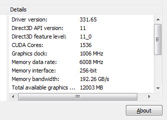

Hi Paul
My windows version should be listed in my signature.
Where do I see my version of the cuda driver?
I have added a screenshot - does that tell anything?
The plugin is not activated when I restart Revit.

Hi
You are running Nvidia drivers version 331 - which there have been many problems reported with (and I've posted in these forums recommending against using it). Pls try the previous Nvidia drivers.
