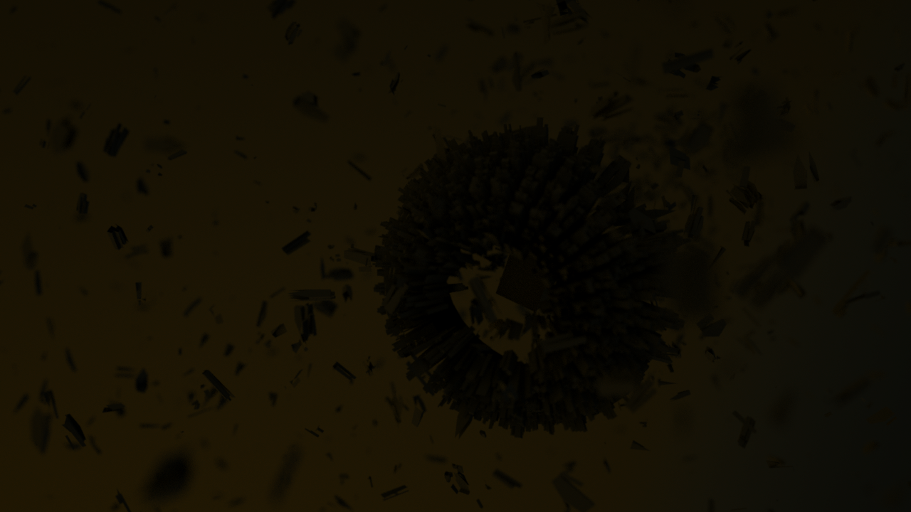

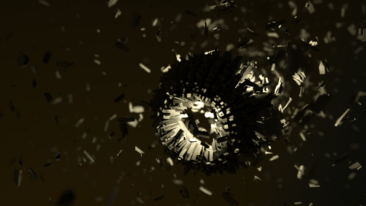

I am note sure if this problem has already been addressed (yeah I looked through the forums). Its simple, I follow standard procedure exporting my blender animation, I assign one material to be an emitter and save the .ocs file. When i give the command within blender to render the animation all other materials are just as i set them, with the exception of the emitting material it reverts back to a glossy material (See images below). I am sure that I am missing a key component here. Or is it not possible to animate with emitters yet from blender. All other animating is working as expected.
I am using blender 2.49a (compiled with python 2.5.4) exporting to Octane 2.3_4 Using the 2.2 script.
how it renders as animation
How the image should look

I'd bet dollars to doughnuts you need to flip normals on your emitters. Octane only emits from one side of the normals.
I've requested that we be able to flip in octane, or ignore in octane and have it emit from both sides, so we'll see if that happens anytime soon, however in the mean time, you just have to fix in the modeling application.
(I think Blender struggles with getting normals correct)

Well messed around with the normals this morning, and nothing new. It is like Octane is not saving the material settings of the emitter exclusively. Everytime the material reverts back to a non emitter once I try to animate a sequence. On the other hand its probably Blenders fault or mine :?
This is a bummer so far. Working on some Senior thesis stuff and am getting behind. HELP!

I think it may be a bug. There are quite a few hanging around animation in Octane at the moment.

Same problem within Octane pre 2.3-3
