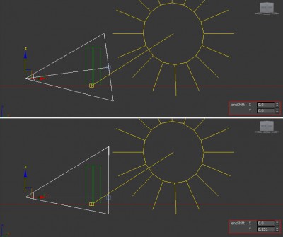

I can´t find a way to correct the perspective, exist anyway to do the camera correction to the perspective? this feature is very important for architecture visualizations.

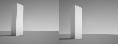

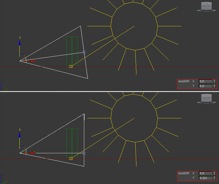

play with a lens shift =)
it should do the trick =)
update:
here's the side view, and settings/ to get the point:
& here's output You get after small tweak:
basically You camera direction should be 90 degree to the vertical surface to avoid convergence or 3 point perspective =)but if You do so, You get problems to frame, forcing You to choose wider angle or show some unwanted part of environment..& sometimes that isn't the option.
Leave the cam direction to avoid conversion, but use Lens shift in order to offset camera plane so You wouldn't loose intended framing =)
cheers
