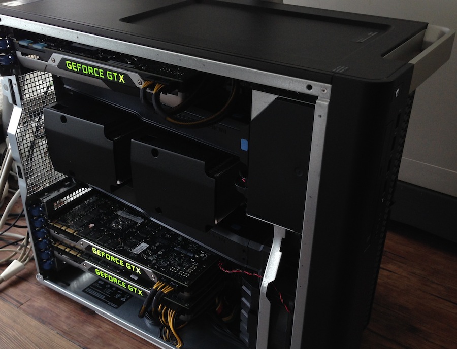

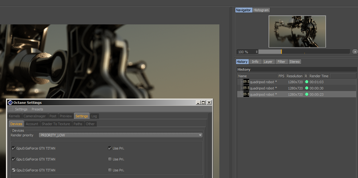

DELLTM PRECISIONTM T7600 (DUAL Xeon E5-2630 / 32Gb Memory)
GTX Titan 3Way (All Pci-e 3.0 x16 - Nvidia Force Gen3)
Render Speed
1x Titan = 1min 03sec
2x Titan = 30sec
3x Titan = 23sec
Use 2x Titan, Twice Speed... Wow
But 3x Ttian, Not Fast..
I want your opinon.... Thanks...

My opinion is that your math is shoddyeyeonestudio wrote:System
Render Speed
2x Titan = 30sec
3x Titan = 23sec

Ah.....
That's esay Math. Thanks....

very interesting placement of that top card,
first time I see smth like that! =)
nice rig!
cheers
nice rig!
cheers

DELL T7600 & 7610
Not Good For GPU Render System
1,300W PowerSupply has Only Two Set Of 6Pin-8pin
So... Need Sata Power to 6Pin-8pin Cable
Can't Closing Cover.
Some Part Stick Out inside Chassis Cover
Slot:3 (16x 3.0 - Need Second CPU Intall)
Slot:0 (16x 3.0 Primary)
Slot:1 (16x 3.0)
Slot:1 (16x 3.0)
