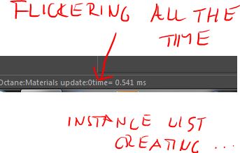

1. In the Info-Bar there is flickering the text: "INSTANCE LIST CREATING..." without stopping

mograph+instances can cause this flickers on geometry updates. Ignore it.
if you have hardness on mat. previews keep open octane dialog or restart a render
if you talk about standart materials, plugin does some convertion but it's not enough for complex materials
