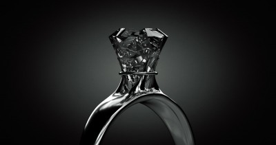

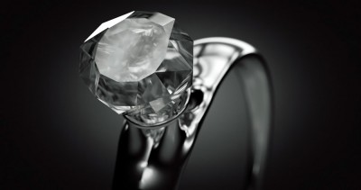

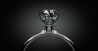

just a simple ring renders
PMC/5
3000 maxsamples
2K resolution
approximately 30mins for each frame on 2 X 660GTX
the ring

They are really nice renders but I think there's something off on the refraction.
slepy8 wrote:должно быть, Вы правы братана.
Я использовал надлежащие IOR но, похоже, это не достаточно.
А как вы предлагаете изменить настройки материала, чтобы получить лучший вид?
it isn't enough to have the correct material still it is necessary to make the correct environment.
The simplest way it to place a ring in HDRI an environment of high quality
Seems like there is too much smoothing on the diamond. The facets need to be harder. In Max, you would use a smooth modifier and unclick 'autosmooth'. This has the effect of sharpening the facets.
The diamond also needs some diffraction. This effect is what makes a diamond a diamond. The correct Abbe value should give you this.
