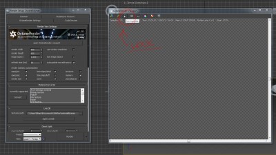

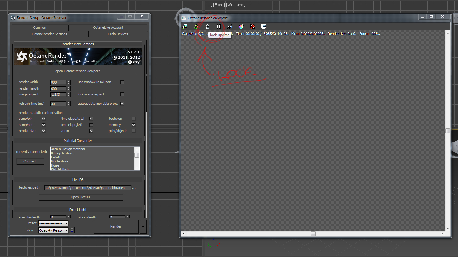

glimpse
Posts: 3740
Jorgensen wrote:where is the lock button?
so, once You're happy with Your camera, just press the button and it will lock the view, so You can get out of Your camera in a vieport and work on the model, while Octane is still rendering =) it will not update the model, unless You press 'update render geometry', the one before lock button.
One thing that I noticed is that some differences appear in render window once You get out of camera view, probably because Octane applies imager settings not from camera, but from render settings (not sure though =) but that's not a big deal, 'cos once You're happy with the result & let's say want to save the image), just switch to the camera and tone mapping is applied again.
gueoct wrote:While working i need to lock OctaneViewport to a certain Camera AND see a current update!
You'll see all of the changes You do on material side, but not on camera or lighting /if You use octane sun system) & geometry.
but I agreee with You on that, taht it's not perfect. In some cases it works in some it don't. Maybe having something like active shade viewport, that You leave open and it updates everything You do might even fit better.
