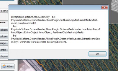

Hello Paul,
I was facing a similar problem recently, is there also a limit on the polycount per object?
A few day ago I was trying octane on a complex train project, to optimize display performance I often join all meshes sharing the same material (in rhino this can totally boost the display speed).
I got this error and certain objects did not appear in the rendering after voxelation...
Is this per Object limit raised in the next Version?
It would also be nice to have a error message like "object xxx exceeds the maximum amount of possible polygons per object (1.000.000) - try to split object into several parts"
best regards Andreas

The limit can be user-set in the next version, and the error handling is much better. I think the current version is 10 million per Octane mesh (and if you set Live Geometry ON, those meshes will be treated as separate Octane meshes).Is this per Object limit raised in the next Version?
Paul
