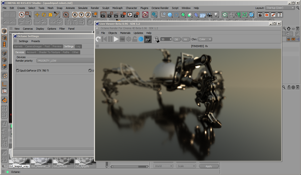

Here is My Simple Driver Test.....
System
Dell T7600 (E5-2630 DUAL, 32GB Memory)
Nvidia GTX 780ti (Driver 331.65 WHQL)
All Version with SDK 1.2 (It's Same Libary). Only Different Plugins.
C4D R14.042 + OctaneRender 0.72B ---> All Ok
C4D R15.037 + OctaneRender 0.72B ---> All Ok
C4D R14.042 + OctaneRender 0.82 ---> All Ok
C4D R15.037 + OctaneRender 0.82 ---> All Ok
C4D R14.042 + OctaneRender 0.87 ---> All Ok
C4D R15.037 + OctaneRender 0.87 ---> All Ok
C4D R14.042 + OctaneRender 0.96 ---> All Ok
C4D R15.037 + OctaneRender 0.96 ---> All Ok
How?
Remove TurbulenceFD Plugin....Just OctaneRender Load
Or
TurbulenceFD + OctaneRender Load.
Copy c4doctane/Lib64(octane.dat, octane.dll,vcomp100.dll) to C4D Root Dir
Do not copy nvapi.dll
