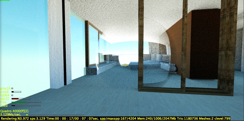

Hi, I have a problem with glass materials. When I use material crystal the same scene turns out to be reflected in the same one inside a sphere, why this happens? I need urgent help, please. I attach images where it appears

weegee wrote:Hi, I have a problem with glass materials. When I use material crystal the same scene turns out to be reflected in the same one inside a sphere, why this happens? I need urgent help, please. I attach images where it appears
you sould put a phong tag with low phong angle

thanks aoktar but it did not work. I continue without solving the problem.

weegee wrote:thanks aoktar but it did not work. I continue without solving the problem.
Thank you again.
check twice. this kind of look on flat surfaces happens with wrong phong angles. Or you could not accurately describe the problem
Posts: 10363
hi, if you use the specular material, the sheet of glass must be extruded just a bit, otherwise the room react like a big magnifying glass ;) take care also of the normals direction ;)

You have reason aoktar, I have not explained well, my Englishman is very limited and I cannot express how i wish. I am trying again with bepeg4d's indications, communicate it to all that it knows something you.

I had the same problem.
Thanks Beppe!
Putting the glass plane into the cloth nurbs and giving it a thickness of 0,3cm happened to be a solution with me. :)
