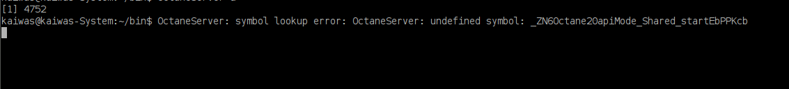

kaiwas
Posts: 44
Joined: Thu Jul 11, 2013 7:35 am
Hi!
OctaneServer 2.5 does`t start (
we have to use from 2.4.
grimm
Posts: 1332
Joined: Wed Jan 27, 2010 8:11 pm
Location: Spokane, Washington, USA
Hi
You probably have an previous version of the liboctane.so file in your path. Make sure to remove all the old libraries and just point to the new version.
Linux Mint 21.3 x64 | Nvidia GTX 980 4GB (displays) RTX 2070 8GB| Intel I7 5820K 3.8 Ghz | 32Gb Memory | Nvidia Driver 535.171
kaiwas
Posts: 44
These files are not replaced by new ones when you install *. run?
try it

kaiwas wrote:These files are not replaced by new ones when you install *. run?
try it
I install mine manually because the install program doesn't work on my distro. I had this same error when I installed this new version. The reason for the error is that there are new functions in liboctane.so that are not in the older versions of the library. I put the library in /usr/lib64 but I still had an older version in /usr/lib. The OS finds the /usr/lib file before the /usr/lib64 directory is searched so the new version of the plugin tried to use an older version of the library and it will not work.
It's possible that Jimstar has changed how the installer works and it's placing the library in a different spot. You could go into your /usr/lib and /usr/lib64 and remove all liboctane.so files, then re-install. That would fix it, just be careful to not delete any other files. :)
kaiwas
Posts: 44
Thank you!
everything worked
