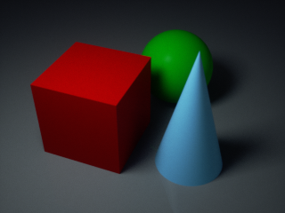

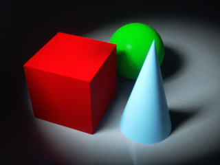

If I use a simple primitive square (DAZ primitive plane object) which I then use as mesh light emitter that has an IES map applied to it and change the X-axis orientation in the material properties by 180 degrees the light is being emitted in the direction of the plane's normal.
This renders fine in the Octane viewport. However when I hit the Final button in the viewport it changes the orientation of all my meshlights which makes the use of the button useless as it breaks the lights in the scene.

- Viewport render with FINAL button pressed.
- IES_bug_final.png (79.26 KiB) Viewed 2011 times
- Normal viewport render.
- IES_bug_normal.png (93.75 KiB) Viewed 2011 times

well, this is a problem with the mesh combining (which is "on" by default);
as long as "final" is not used, every scene object is sent to octane individually, and pos/rot/scale transformations are applied "virtually", means instead recalculating the geometry and sending it to actane again i.e. only the rotation vector is sent, and applied by octane internally. this allows very fast positioning updates.
when final is clicked, and the "combine meshes" setting is on, all the geometry is collapsed to a single mesh, and now the transformations actually alter the polygons position and orientation and so shift the ies rotation. something similar happens with scaling where the light intensity would change when the polygon size changes. note: in this case the plugin currently skips fast transformation updates - when a object is scaled the geometry is recalculated every time anew, and only pos/rot is applied through the engine.
there are two workarounds for using ies: untick the "combines meshes" setting for the final mode (in the preferences), or apply the rotation directly with the orientation sliders of the emission node (the latter only works if the object origin is at world center, what is usually not the case when adding primitives to a scene).
the new version (still under heavy construction) will most probably skip mesh combining in such cases, to keep everything in place, scaled mesh lights as well as ies position and orientation; btw, it also needs to skip collapsing as soon as instances are used, as they of course need the instantiated object as an individual/single mesh.
bottom line is, that combining meshes can gain some nice performance boost - depending on scene contents - but has some limitations that can not be easily worked around (but to don't use it)...
