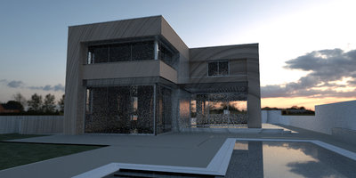

Hello every one I'm pretty new to this software and I have tonz of questions but to start, I would like to know if you guys know what is that cicle like shadow that I have in the image, even before I start applying textures is there.

strange cicle image
The circles are there because your scene is probably a kilometer wide.
You need to address your scales either in 3dsmax or via the octane mesh import units.
