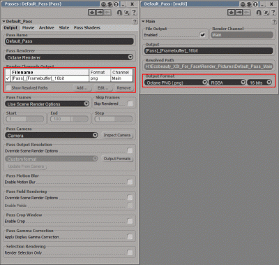

Where does octane save the rendered images when using render current frame/pass? It doesn't seem to use the standard tokens from SI to generate directories and save the output there. Am I missing something?

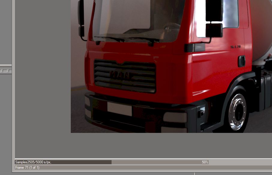

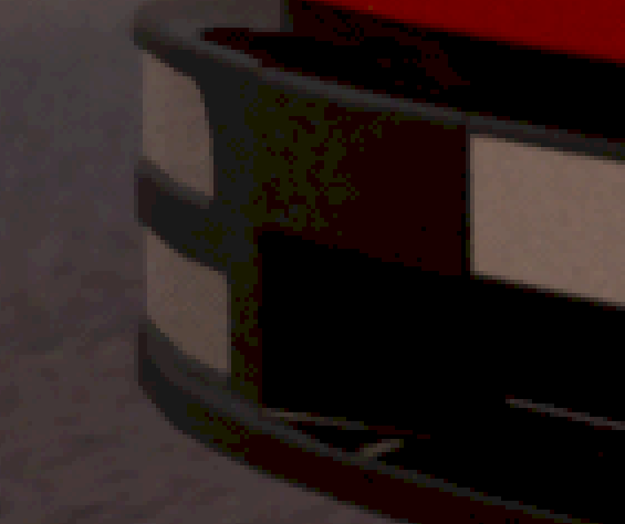

The framebuffer seems to be 8 bit? Also it saves 8bit images which look horrible in low light areas...
And all my shaderballs render black. Not fully implemented yet?
Image save location? Framebuffer 8bit?

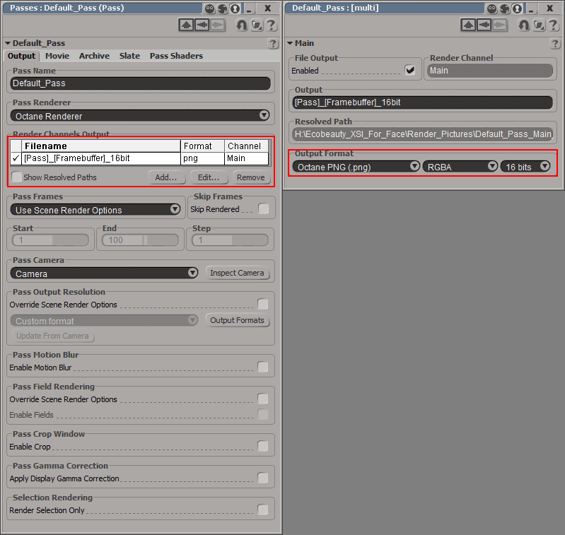

Ok, If I enter an absolute path, octane will write the image there but alas the same 8bit output as in the framebuffer. Not usable.
You can change the image type in the pass options to png16 or exr.

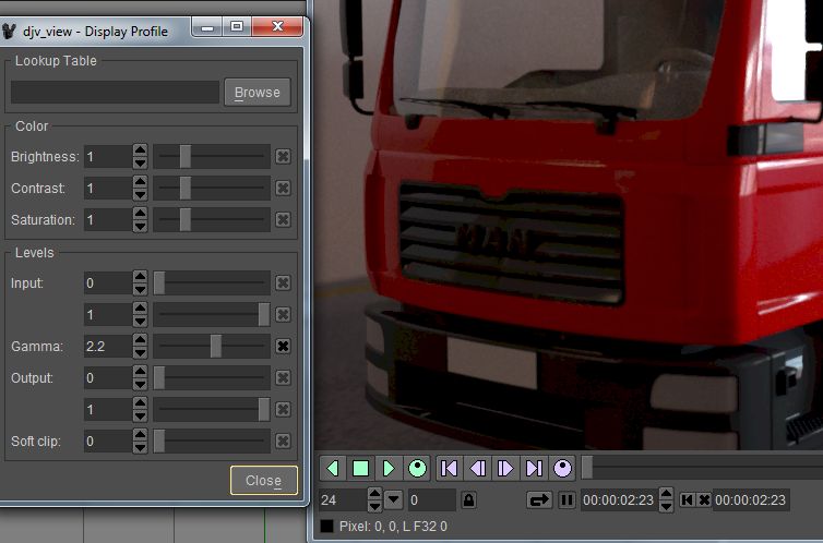

This is the 16 bit png! I only applied the standard 2.2 gamma and made a screenshot from djv. I've attached the original as well. We've seen exactly the same with vray's render region which has been 8bit (display) too until recently.
Are you planning to implement SI tokens as well?
Edit: It seems a djv display problem, when I open it with nuke it's fine. This leaves only the Si frame buffer issue.

I checked again, djv doesn't apply the correct color mapping to the 16bit png input . The display gamma is applied to the 8 bit display which of course looks crappy.
The octane exr is fine!

Ok, looks it is ok so far?
Haven´t found a documentation, where i can switch the preview output to 8/16 or 32 bit.
I think it should be managed automaticly.
I have a check in my render fragment class, this is the class which sends the RGBA scanline to the framebuffer.
I check also, which bit depth the render manager currently use. He will only use the 8bit output.
It is irrelevant which option i choose in the render channel output.
The funny thing is, when i check, which bit depth the current display framebuffer can use,
i get 8/16 as depth for png and 32 for exr, dependet from the render channel output i choose.
I can also swith to exr and the framebuffer can only use a depth of 32, but he uses a depth of 8.
This is a little bit wired. Maybe i should contact the support.
Currently i use Softimage2013 , will test it with 2014, maybe it was a bug and it is solved...
