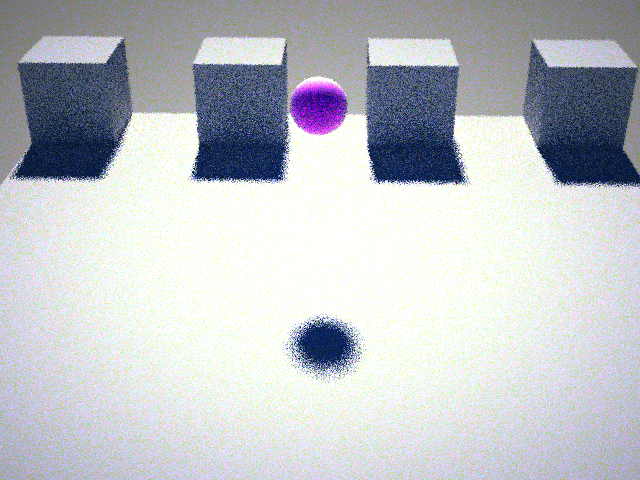

There is a catch: between passes, the samples are NOT randomized, so whatever noise patterns don't get shuffled and instead kind of 'multiplied' between passes, so it looks noisier. Amazing how a simple fix hasn't been delivered!

if we are talking about the multi passes on each individual frame... then no, they are notKarba wrote:They are.Proupin wrote:the samples are NOT randomized

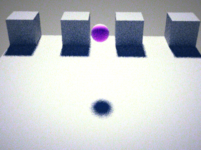

About the amount of samples (and this is related to the noise I observed): let's say you get a clean image (without MB) after 3000 samples. With motion blur and 30 passes, to have similar render times, it should be enough with 100 per pass (meaning you should change the max samples to 100). Each pass will contribute to the final render (so 30x100=3000 samples total)... but in reality you will see you need more samples per pass, because of the noise pattern not changing (test coming later karba)...

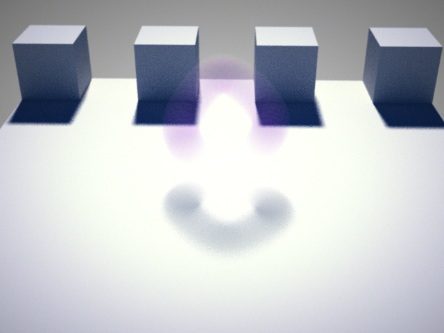

I just tested it succefully in 3dsmax...
It's true that it is a rough and consuming time way to produce MB but c4d do work the same and gives correct results when diplaying the video generated: you only see the ghosts effects of the MB when "pausing" the video.
I hope one day we'll have a true physical MB usable in Octane for max and c4d...
