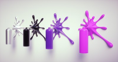

modeled to be 3d printed - as type of street art sculpture
- splash model in zbrush, spraycan 3dmax

Wow! The second from the right is sss? It looks amazing!

yup, just a quick&dirty SSS in RGB colours - this was an amazingly quick setup, used an HDRI and used a scene I am working on..whersmy wrote:Wow! The second from the right is sss? It looks amazing!
- the concept is for a colleague - he has done one like that from gypsum and now wants one 3dprinted and to make moulds out of that.. now to see if the workflow from zbrush to analogue reallife product is going to work
- it's a great showcase model for SSS I might do a rendering with a whole bunch of them in sss

The idea is very good.
The splash is only a bit thin where it comes out of the can, so the real 3D printed model will bend and break.
Make it a bit stronger there.

- good observation
, as I sad a quick rendering, I am making those modifications right now since I got the same feedback from the author
- it is also going to use a wire for structural integrity
