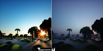

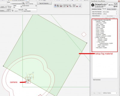

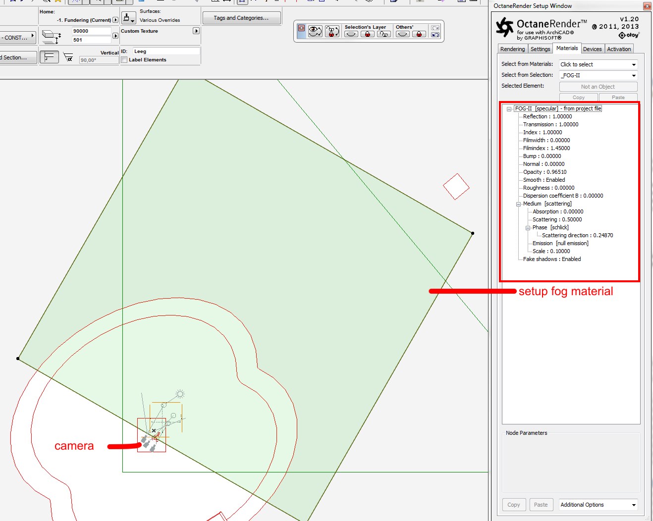

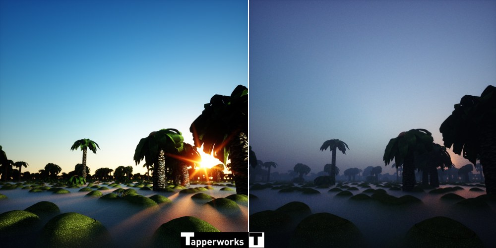

In the attachments you can see my setup and two results with different settings for the fog material.

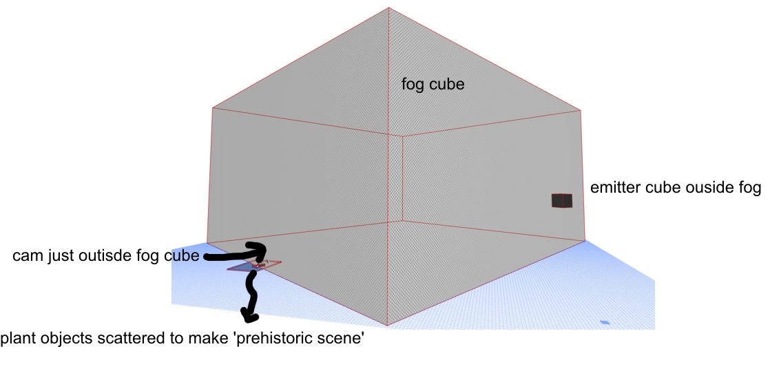

I used daylight, but also a hdr texture environment... I also added a Cube as an emitter at the same place where I put my daylight sun.
I tried different combination with different kernels... but no godrays
 So whatever settings I try I do not get godrays. The thing is I am trying to get result by trial and error,

Maybe I have to work on a differetn scale? This scene is human scale with the fog volume being about 100meters size (height).
Maybe I am having a setting in material or in the kernel that makes it impossible to get godrays
