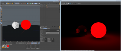

so here's my problem now. About 'luminance material' in octane.
here is what i got when using standard render.
a simple plane (white material), Sphere (red luminance)

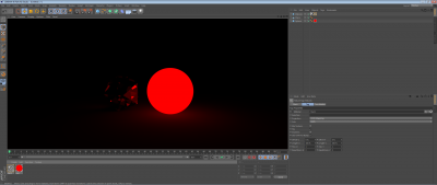

Here is what i get using Octane render.
so what's my mistake again? :D

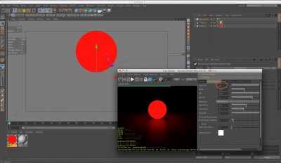

hi,
please, just play with the exposer ;)
note: normally, all the other render engines works only with own shaders, with the c4d-octane integrated plugin you can render everything without converting the standard c4d shaders. Anyway, for best results, it's necessary to convert the standard c4d materials to the octane one ;)

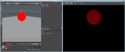

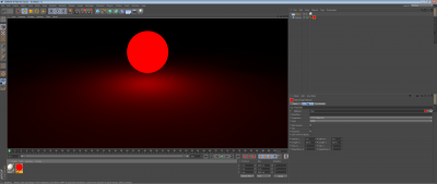

how about this issue. refraction on transparent object.
so here on standart render.
here on octane.
got any video explaining how to render with octane for c4d? i tried to find some but honestly not a lot.

There is some videos, but no special material tutorial. Maybe you can check standalone tutorials, plugin exactly same behaviour. Also i'll try to give some tips.
-Problem is smoothing angle, octane has different behaviour from default renderer. Try lower smoothing values.
-Materials: Octane has diffuse, glossy,specular materials. Which are collected in a type C4D material. You can switch with type option. Every type has own and shared parameters. Specular is most powerfull material, you can do glass or volumetric fog. Mix material only does mixing two materials. And you can achieve some complex materials. Check LiveDB editor for user material presets.
Also i'm going to add more material presets for next release.
-For spheres, untick render perfect option. You can't see any geometry in picture viewer, if you don't do it.
-Use linear input color profile everytime for correct colors.
-Learn different kernels. Each one has own advantages. I use Directlighting kernel for motion graphics.
-Octane is unbiased realistic renderer, you can't replace all areas of standart renderer. But you can get impresive results. I'll try to get mograph shader support for next versions.
-Has no any shadow option, because behaves as real world lights. Only direct/sun light and arealights is supported. Use octanelighttag for advanced control.
-update to last version(0.87b) but install first 0.82 and owerwrite with 0.87b
