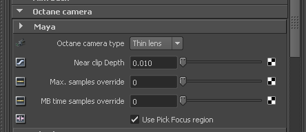

  • Added "Use Pick Focus region" checkbox to Octane camera settings to be able to disable focus tracking by region set in RenderView.

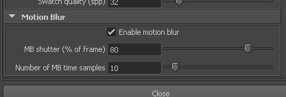

Now Octane global settings have "Motion Blur" section. You can enable the Motion Blur there (it will work only in animation render modes). You can set the shutter speed in percentage of frame, and the number of MB samples created for each frame.
To speedup the Motion Blur render you can have this "Number of MB time samples" value overrided for each camera for each frame: Octane camera now has additional keyable attribute "MB time samples override". If this value is "0" - no override to global setting will be made, but if it has the value - this value will be taken.

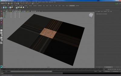

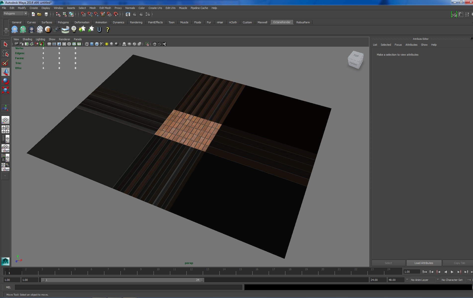

By the way when i apply texture to the object via octane material and when i press 6 to show the texture in the viweport it will be very bad and i can not control it..
