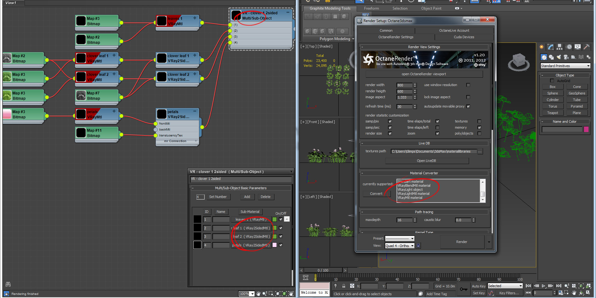

so here's a print-screen attached..
I've just circled few areas - one is multi-sub mat, other is two sided materials and the third one is supported materials for conversion.
The problem is that 3dsMax, or plugin couldn't convert these mats. What You have to do is: a) split these into diff objects with, different mats, apply them with individual mats b) have one mat with UVs unwrapped & paint some masks depending on which part of the object You want that the separate material would effect and do some work in Octane layering down mix material with masks.
So =) there's no easy way to do this =) but I'll try to figure out something. maybe - first solution would be good enough to work, if let's say..selecting by material ID and detaching as diff object..
B solution should work perfect (I've already used it) but it's far from shortest way of doing that =)so, sorry if i can't solve it fast =) maybe I'll try to write a tut on that or something.
Or maybe others will find different approach =) & please do share an option if You find any =)
