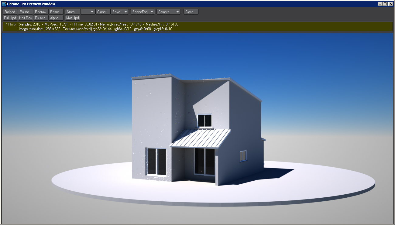

Problem with artefacts after adding windows . PathTracing, samples 2000, Depth 16
Thanks in advance
juanjgon
Posts: 8867
Location: Spain
This is a noise from high energy random specular samples, perhaps due the specular material in the windows.
You can use the "hot pixel visibility" parameter inside the Imager:Camera node to fix the problem.

For the moment (I'll do tests) I use the simple glass LW, less noise!
One note: I had some problems after a Boolean operation. I have triple polygons if not, I have rebels polygons that appear.

BorderLine wrote:Hi and thanks,
Pb solved.
I decide to use Octane for the first time in production and I use many instances and only pathtracing, no problem for you?
Some tips perhaps?
Another note for IPR window that always happens in the selected format. Is it possible to block its size once and for all?
Octane only support simple convex polygons. If you have complex polygons or polygons with holes you need to triple them before use the object with Octane.
Instances works fine AFAIK.
You can configure the default IPR window size in the plugin options panel (default, render resolution or custom resolution).
