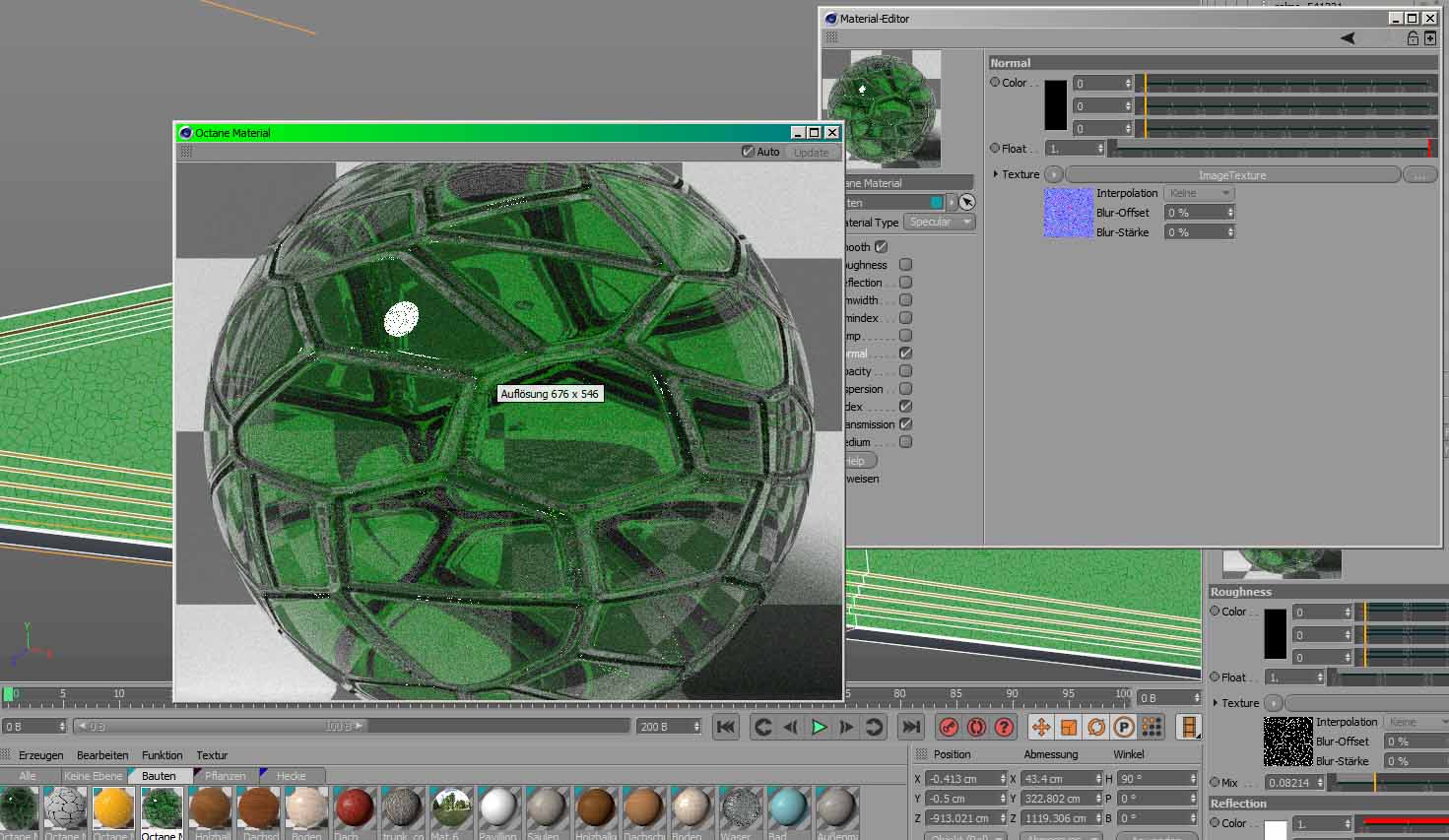

1. Material Specular
I provide a glass with engraving from Normally Map.

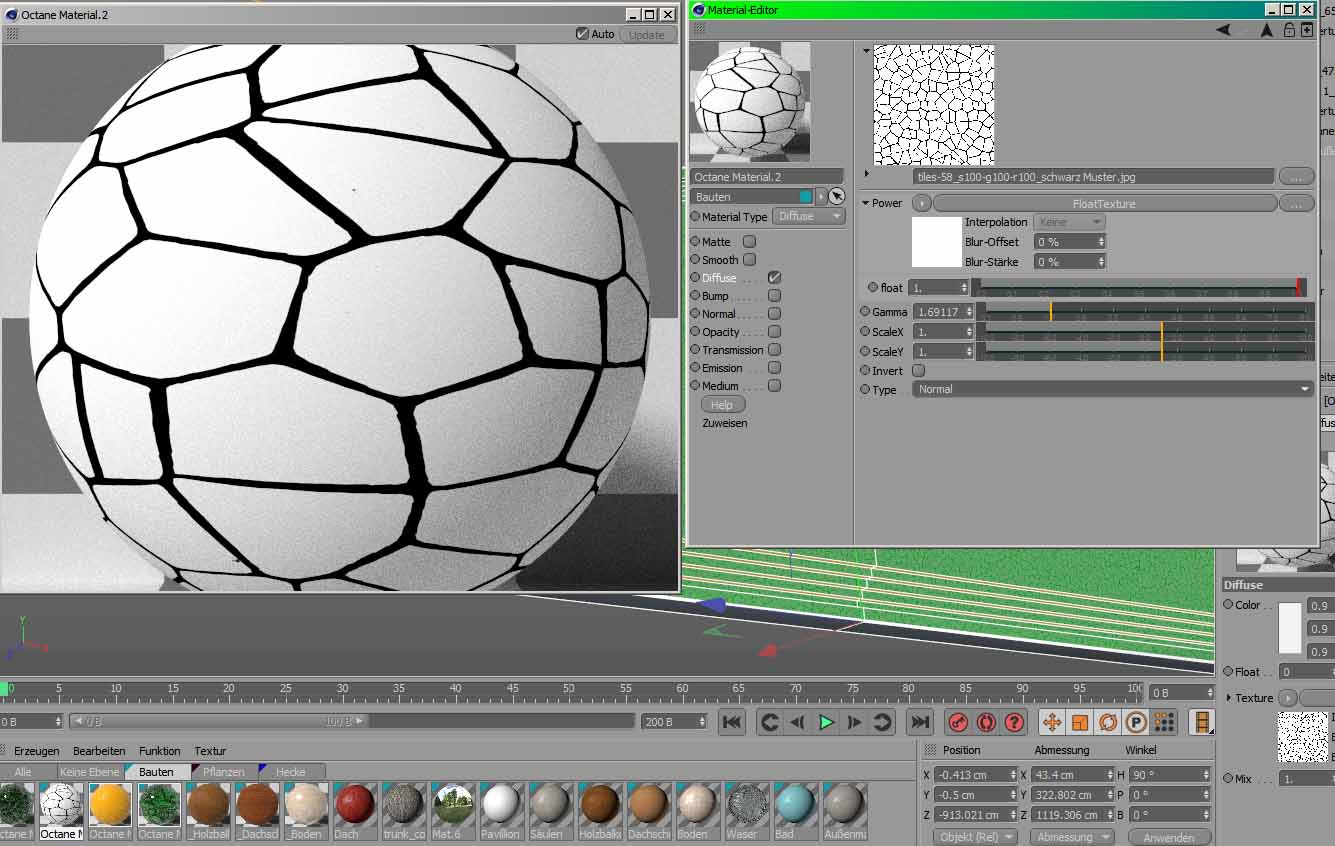

2. Material Diffuse
I provide black/white pattern

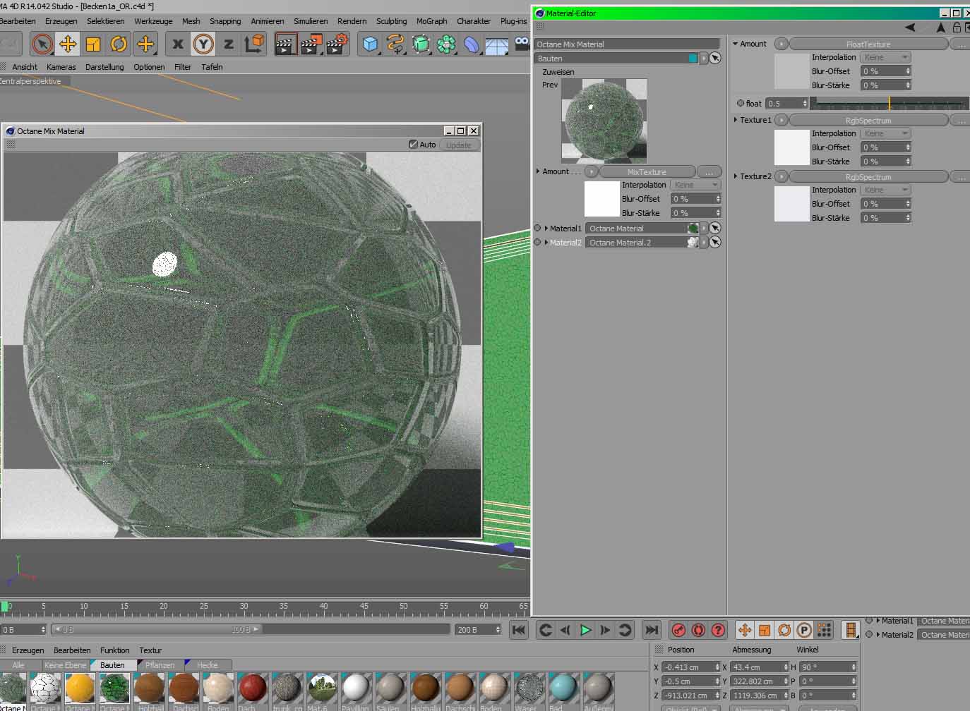

3. Material mix material
The first one and the second material are brought together.
Indeed, I do not succeed in filling the engravings with Black.
What must I do?
Or does this not go? What I do not hope really and think.

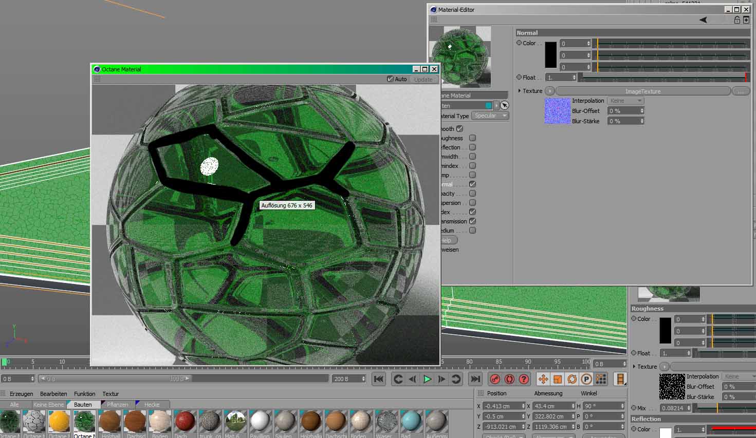

Black pattern on glass materials
you should'nt use float texture on mix material. A image is best choice which is similar to like in second image
My english is not the best. It is to be maintained really hard me in it or to understand.aoktar wrote:you should'nt use float texture on mix material. A image is best choice which is similar to like in second image
How do I do this? Nevertheless, Float is present everywhere.
The black must be also not black maybe gold or anything else. It should look massively on glass.
Unfortunately, one has in the glass canal (Specular) nobody Vaguely. With it I could lay a texture about the glass.
But thus I simply do not do.: (
