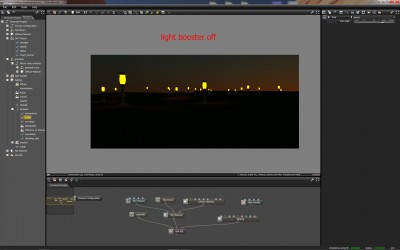

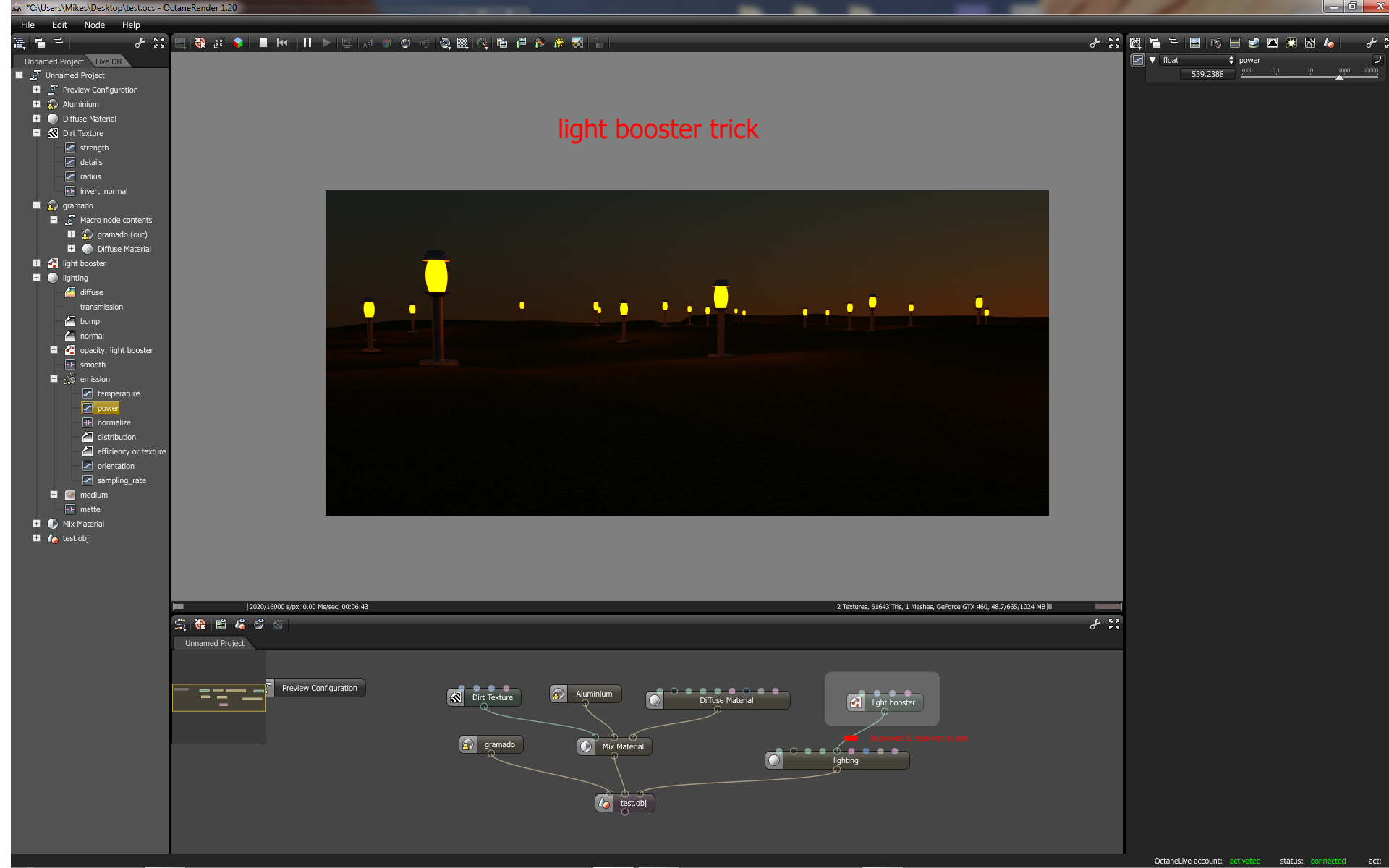

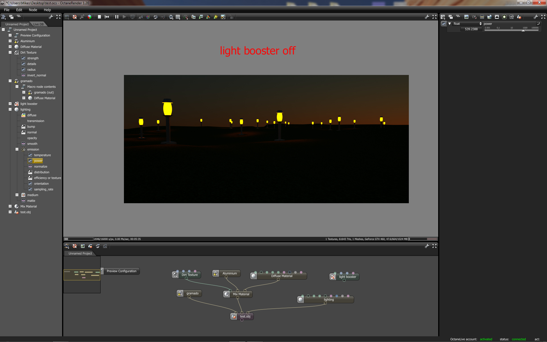

The light booster trick is basically a mesh or other type of opacity map attached to the opacity channel of a blackbody emitter.
Please see attached the screen grabs showing it disconnected and connected.
