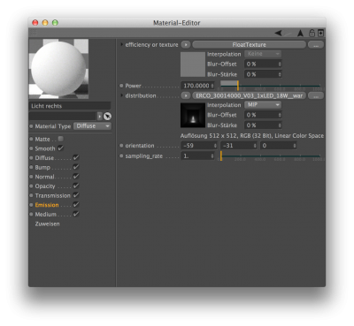

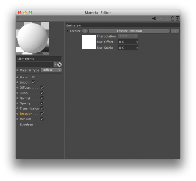

I had also problems to rotate IES lights. My solution is to create a polygon, orient its surface to the direction I want to be lit and apply a material with a texture emission. Then I was able to rotate the IES in the material editor and not in the tag (which indeed seems to have a bug).
