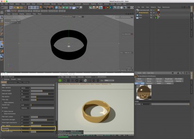

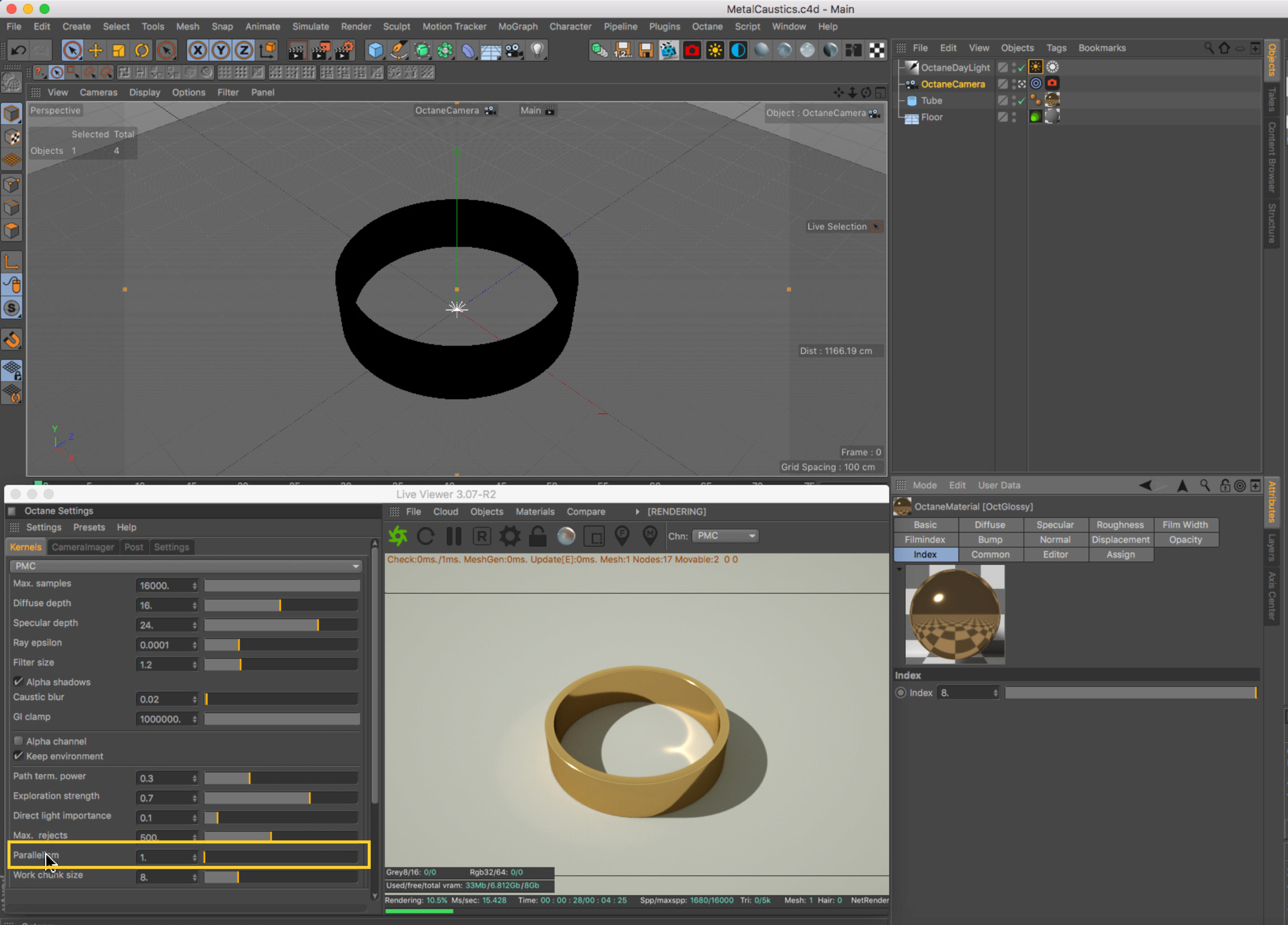

Hi NNeuland,
you need a tiny strong light source for good caustics pattern, and PMC kernel with Parallel sampling at 1.
You can also use PT with high Max sampling and Adaptive sampling, but in general, PMC is more efficient in this particular condition.
ciao beppe

Posts: 10654
Hi NNeuland,
oops sorry, not Parallel sampling, but Parallelism at 1:
metalcaustics.zip
(64.28 KiB) Downloaded 609 times
ciao beppe

Hi bepeg4d.
This was very helpful. Thank you so much!
Viewing your "metal caustics" project was very informative. I'll need to play a bit more with this to build a lightbox to shoot
silver objects and get the caustics effects using artificial lighting and not daylight . Thank you again for your help.
