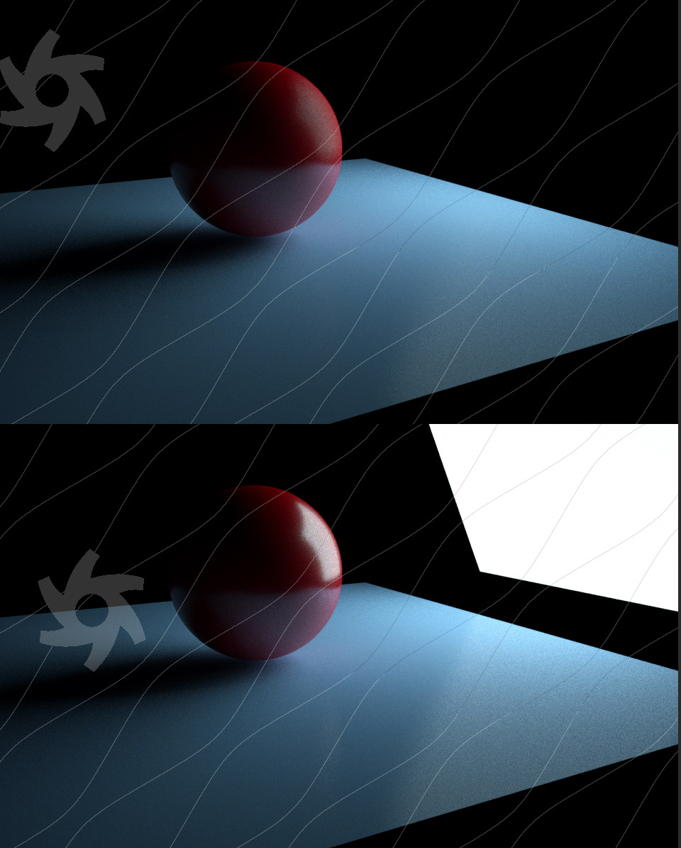

Yes indeed, larger lights do seem to react differently. I'd obviously never tried hiding a large light.maxwater wrote:thanks alot ! i took your scene and just made the lightnode a little bit larger to see
more whats specularity and whats reflection. i added a screenshot to show how opacity 0 and opacity 0.5 of the octane-light behaves here.
I have now checked this out in both Maya plugin and standalone and the behaviour seems consistent. Not sure if this is a bug or not but if it is it's with the engine and not connected specifically with the Maya implementation.
T.
