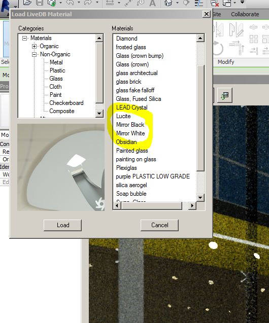

Hi Paul
It looks like the white mirror and black mirror from live DB are the same
Any suggestions how I can make the white mirror into a black mirror
Sorry about the silly question

I couldn't find those materials. Can you provide the category pls? And in what context are you using them? Not sure what is a "Black mirror" is.

Here you go
from Live DB

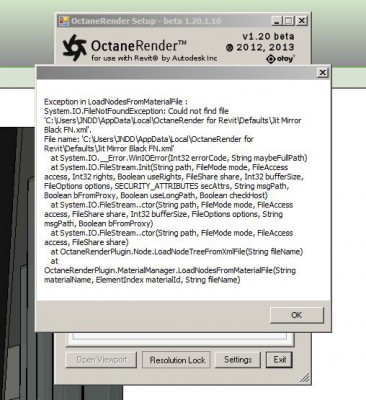

Also getting exception errors
face_off
Posts: 15827
Location: Adelaide, Australia
Was that performing a "Load from Default"? If so, I fixed that today - you can re-download the current version for the fix.
Black and white mirror differ in their diffuse color, but because the specular pin is 1 in both, you never get to see the diffuse color, so I think they probably render the same.

So How do we get a blackish mirror or albeit with a dark tint in it
