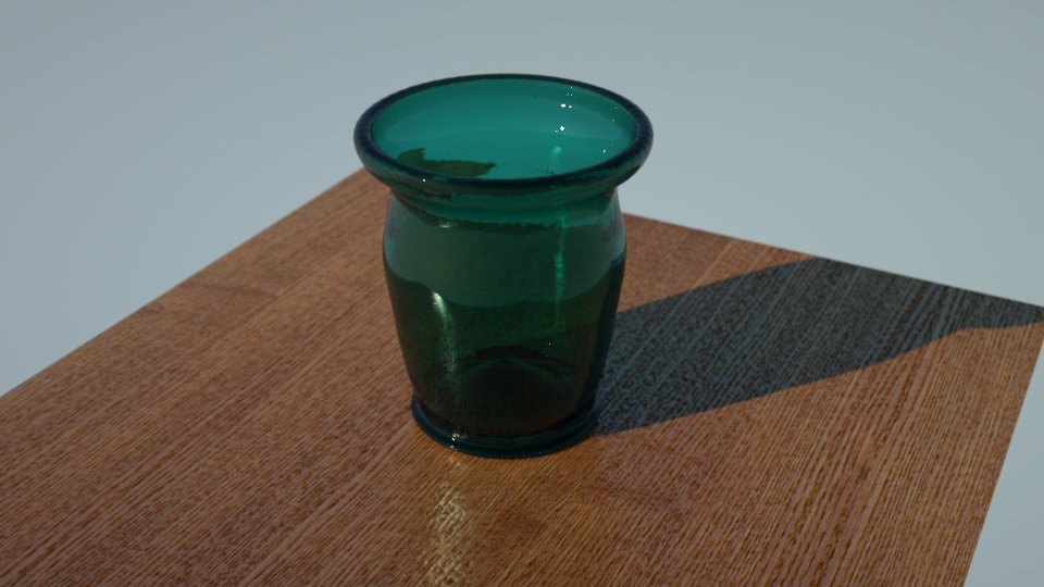

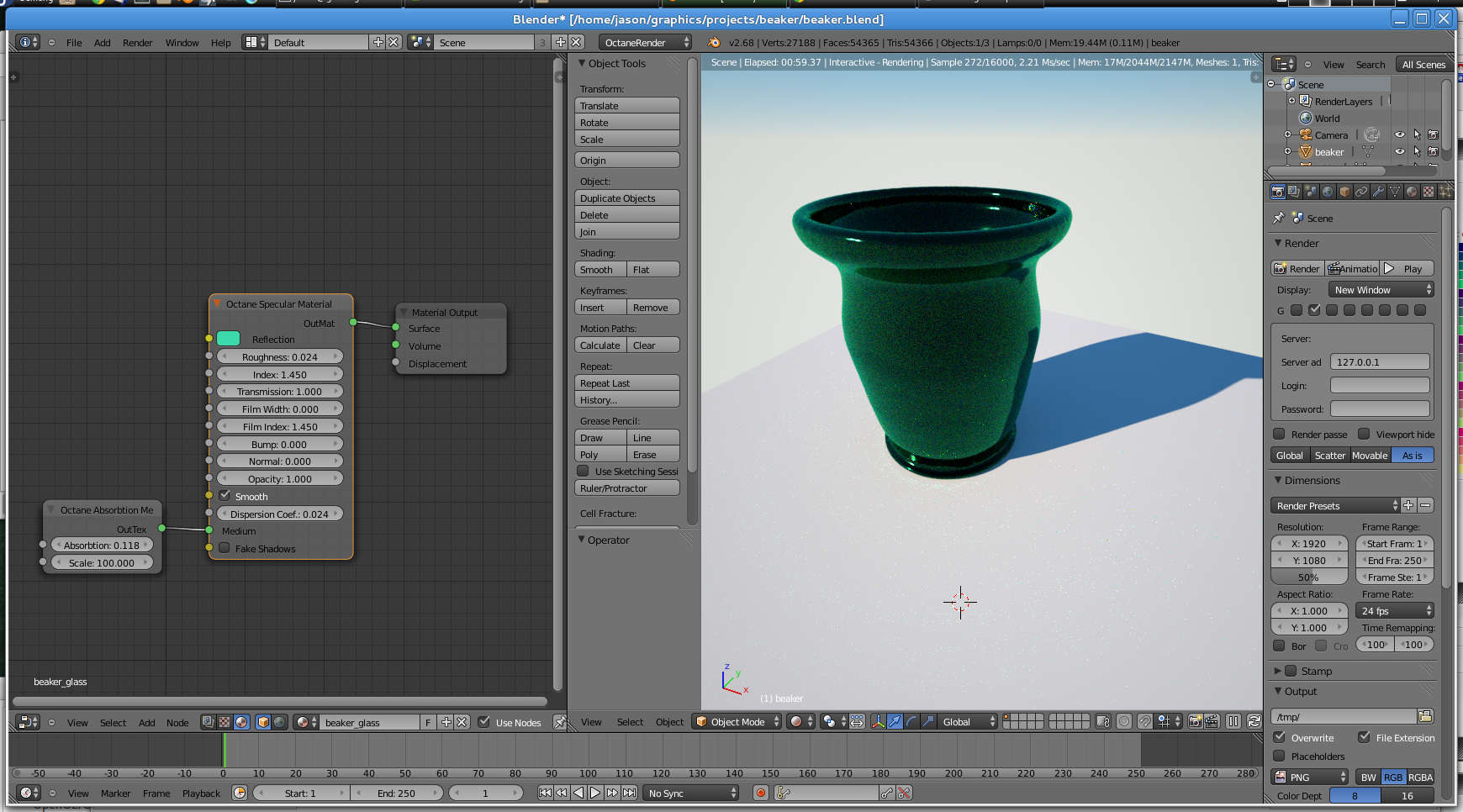

I'm having a problem with the absorption medium with specular material in Blender for Octane. It works in standalone but no matter what I do in Blender I can't get it to work. Basically I lose transparency when I hook up the absorption medium and it makes the object completely opaque.
Here is what it looks like in standalone:
And this is how it looks in Blender for Octane:
P.S. absorption is misspelled on the node. ;)
