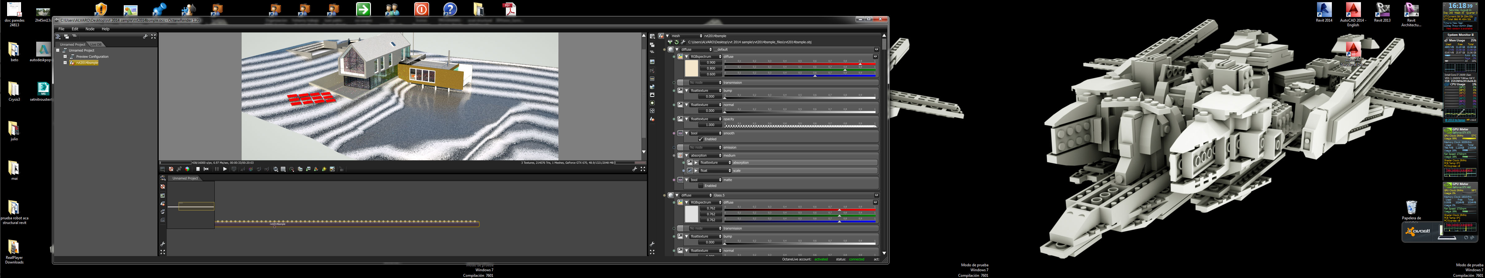

hey it´s completely posible!!!!!!!....I do this....i have instaledd the collada exporter from lumion in to revit (it´s free)....I used to generate a file with all materials from revit...hmmnn later I import this file into a 3d aplication with ann unnoficial exporter to octane plugin into it ( example cinema4d) send the scene to octane and works fine.....

Hi jorgensen!!![....yeah i know...but I understand the question in this way...revit to standalone...and the only way at moment i found it´s this...because I have a node for every material in the scene...if I export from max to obj...all geometry stay in a simple node..
