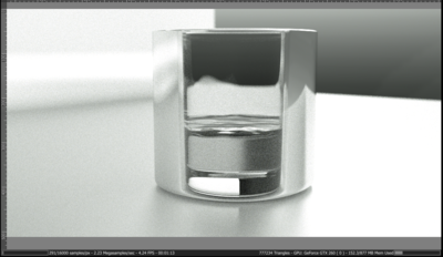

I couldn't believe it, I rendered glass of water, and no fireflies - yay! :)

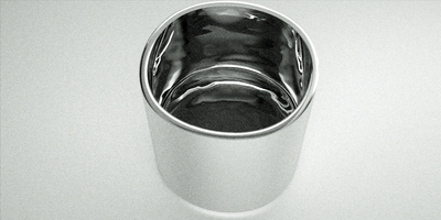

Still has a funky IOR going on ( as shown in 2nd image ) - it's like the glass just becomes a mirror and reflects 100% at some angles far more than glass should as far as I know.
Thanks for the hard work guys, keep it up!
screen cap of glass rendering - great deal of improvement on glass rendering.
IOR with specular and index of 1.45 = some very wrong looking glass I think.

While the results looks strange, it's not clear to me that there is a bug here, the reflections/refractions look correct to me as far as the specular shader goes as it was implemented. It's also not a realistic environment that the glass is put in, which may lead to it looking unrealistic. I'll further look into this to see if it's perhaps a matter of making modifications to our implementation of the specular to support this type of material better.

It seems that the particular shape of this model is what gives the high amount of reflection on the sides. If you make the glass perfectly round, it will be much less. I couldn't find any references for glass with that particular shape to compare ... Also the thickness of the glass influences things.
As for the patterns in the second render, I can actually see similar things in a real glass here. What I meant by the environment is, if it's just a black background with some white dots on it (just guessing, I don' have the hdr image here), there isn't much to reflect, and you can see all kinds of strange patterns.
