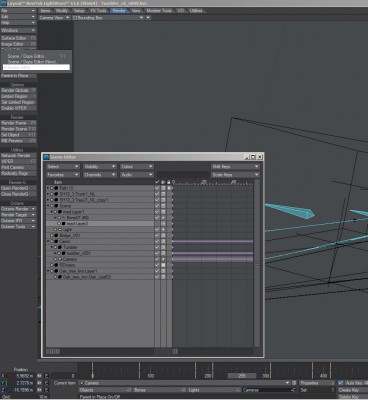

Another bug is Layouts colour scheme goes wrong after an F9/F10 render. (See image).

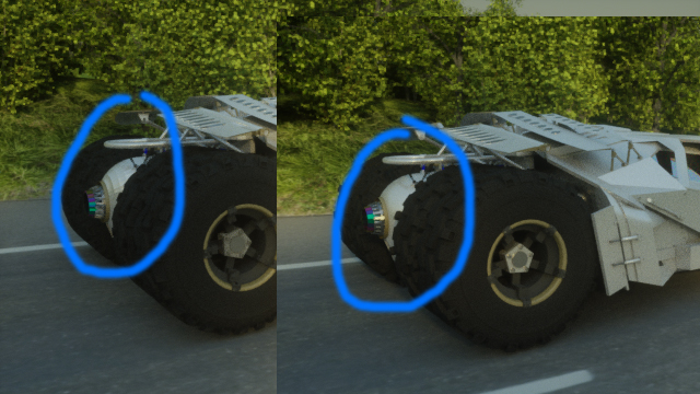

The flickering is the reflections. The trees whip by to fast and cause that flicker.
The car moves around 1.5km from origin, but I don't think that's the problem I've included an image to help show you what I mean.

I see, then problem is that we need motion blur to avoid this problem ... for now there is no easy way to avoid this problem in fast scenes like this one, you are going to need to tune your scene to avoid this reflection.
About smoothing, when you enable the "Smoothing" parameter in the Lightwave materials editor, you need to reload scene in the IPR (use the "Reload" button) to see the effect. This is because when a surface has smoothing off, Lightwave doesn't compute smoothed normals, they are only available after enable the "Smoothing" parameter, and scene must be reloaded to read the new smoothed normals.

Hi Juanjo,
The two images I show above happen on a F10 render, some frames were rendered by octane with out smoothing & most were.
Also when I was surfacing reloading the scene in IRP had no effect. I had also saved the object.
I've got the final animation rendering now, the reflection problem fixed in this one. So far no smoothing problems.

Okay, the problem is still visable in my new render.
Here's a video of what I'm seeing in layout:
https://vimeo.com/73220273
As you can see, the smoothing gets lost for the whole model not just one surface.

Yes, I can see the problem ... in the video smoothing is only visible in the frame 104, not in the other frames.
If you reload scene is smoothing visible for the current frame? ... I think that the problem is there while updating scene. If you render the animation using the option to full reload scene for each frame, available in the render target render options, perhaps smoothing could be OK in all frames.
Anyway this is a bug, if you can send to me the most simple scene that show the problem (for example the car scene without trees, or other elements not needed to see the smoothing issue), I will test it here.
