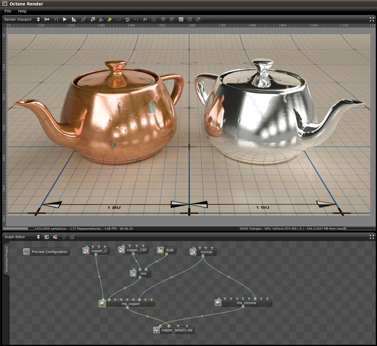

Next I mixed the specular node with a RGB color to further control the tint of the reflection inside Octane. Don't mind the second pot, it's there just for company. :)

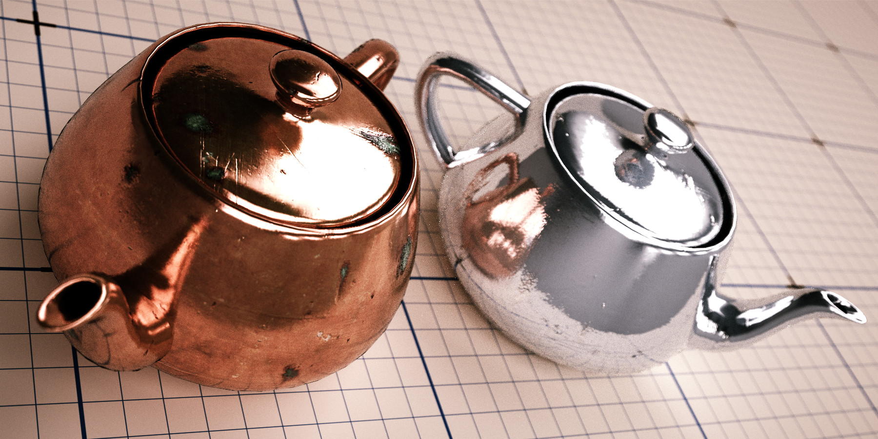

Just for the reference, here's a shot of this scene, that I think is kinda nice (its of lower quality because I didn't let it render long, but anyway)

excellent. The only thing I would say is that things made of copper do not normally use a plating technique. The object would be solid copper.
