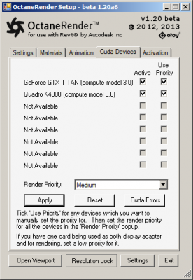

Ticking both GPUs for rendering seems to have no effect? The GPU load on the K4000 remains 0% while the Titan takes 99%. Is there a trick to this?

Here's a screenshot:
cuda setup
cuda setup

So.... we worked this one out - gotta hit the "Apply" button whenever you fiddle with the tick boxes on the CUDA panel :D
All good now, both GPUs getting load and the combined MSamples/Sec = 18.02

You can also turn OFF render priority to get a little more speed. So use the Quadro as your display adapter and have render priority ENABLED, and have Titan with render priority DISABLED. Remember to hit Apply after changing you render priority too.
