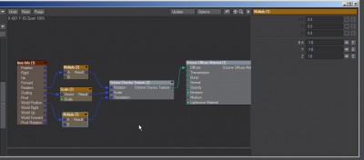

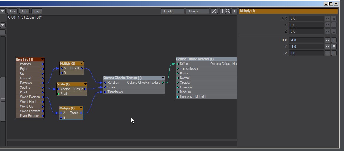

yes Frooze is rightNemesisCGI wrote:I added the check board Procedural texture to an object, but the texture acted like a world co-ordinate texture. As the object rotated the texture stayed in place.
Any one know what I've done wrong or is this a bug?
My set up is as the instructions:
http://www.genesisvisual.com/LWOctane_d ... ction.html
and juanjo gave us the solution
you can see inside the ZIP file of the plugin a sample scene named "dragon_procedurals_with_animation.lws", you ll can see your answer.
above all, look at tjhe node picture below, and say "thank you" to juanjo who make a nice jow
