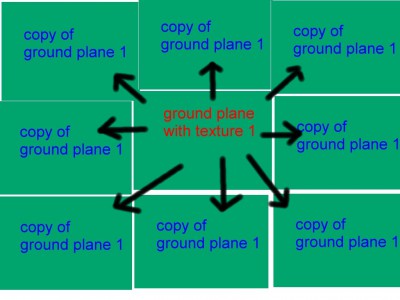

oK, HERE is a pic attached. I want to simple generate these planes from the center one.

Ah - the instance generator will randomise ("scatter") the placement of the planes. I take it you don't want that. You can either create the transform file by hand (very easy in this case), and simply place multiple plane props in your scene and not used instancing. Instancing is design for the random placement of 100's or 1000's of copies of a mesh.

Oh ok Paul,
Yes I know it can generate many random objects. But I thought, since it saved Memory { and
texture memory}, it would be good to use it in this case also.

Instancing won't save texture memory, since Octane manages this very well anyway (for non-instanced items - where is just loads the one copy of a texturemap that might be used many times). Instancing is just a really neat way to replicate an object many many times - and only need to load the goemetry into Octane once. I've had instanced scenes with 50 million polygons, which loaded in seconds. Loading a non-instanced scene with 50 million polygons would take 10-20 mins normally.
