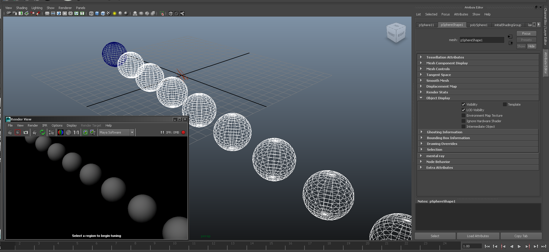

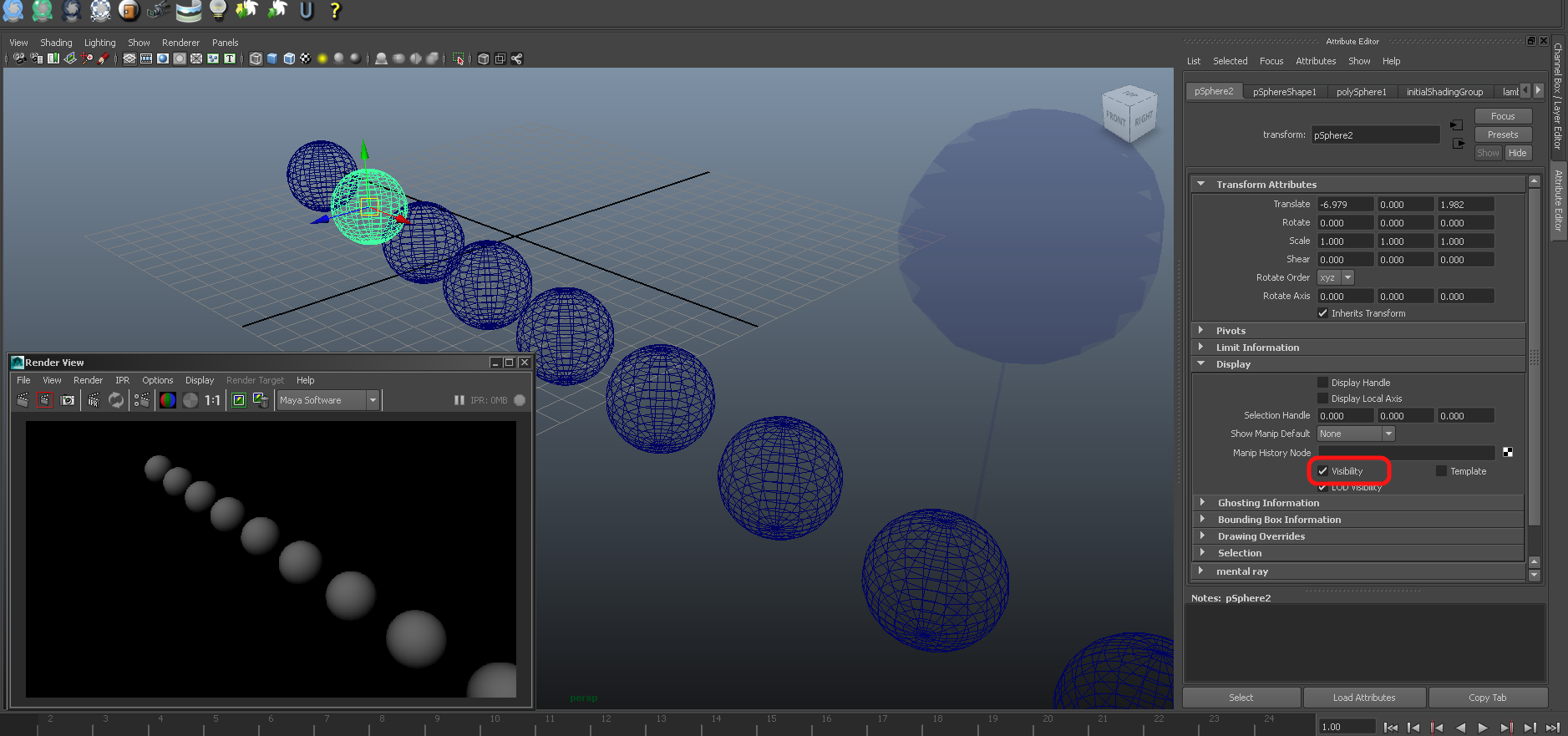

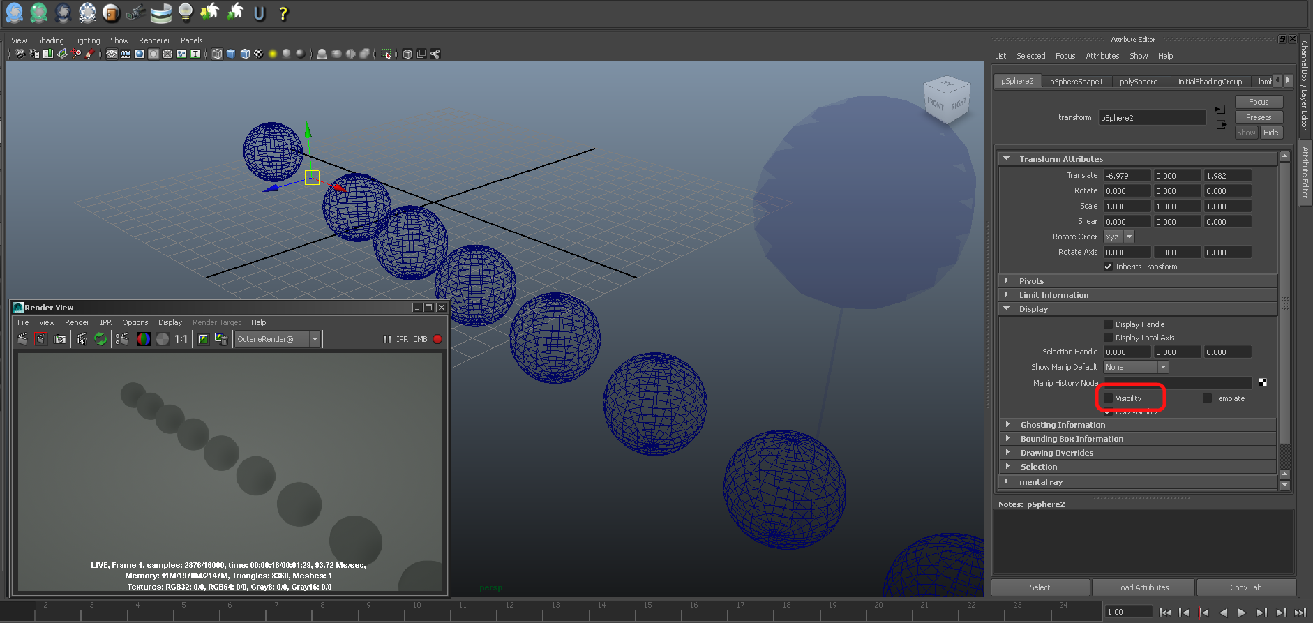

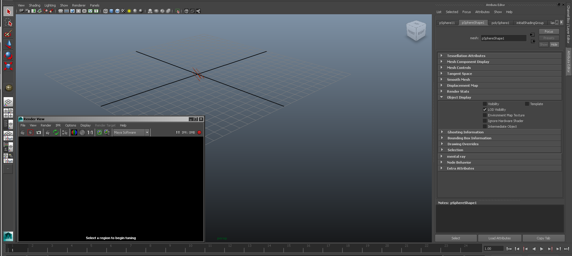

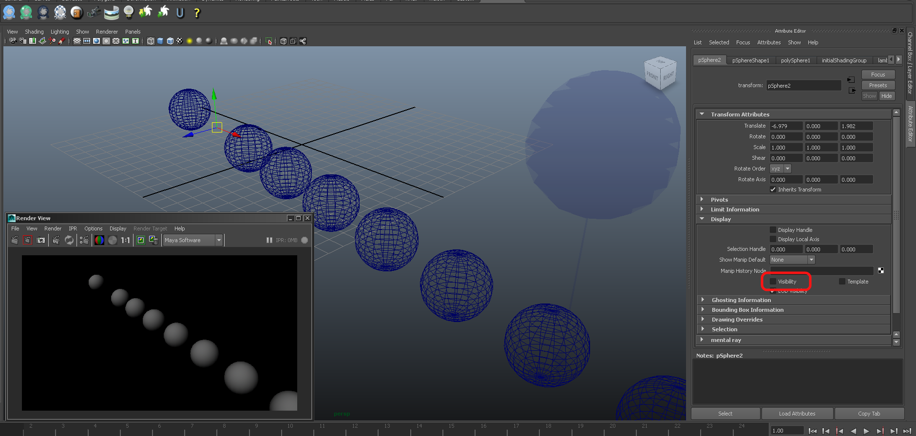

Maya Software renderer, all transforms visibility is enabled:

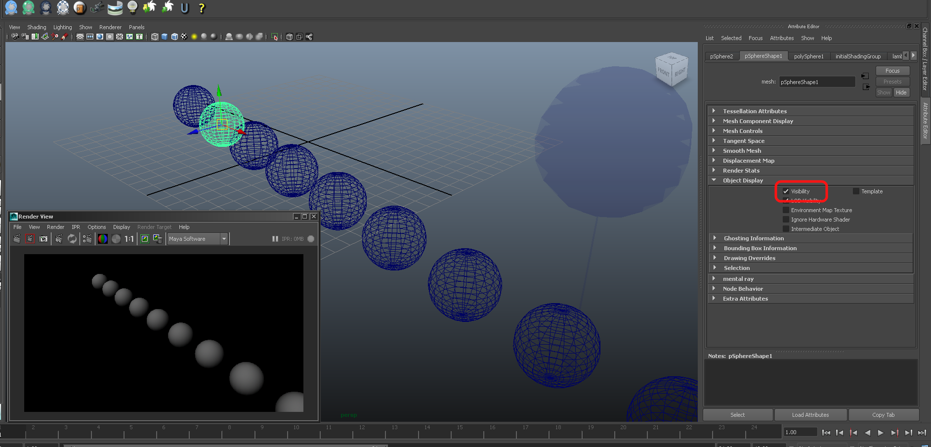

Shape visibility is enabled:
Shape visibility is disabled:

Sorry my explanation was not clear. Yes that is what happens if you set visibility using the shape node but if you leave the shape nodes visibility set to 1 and turn of the visibility on the transform node then the instances should be visible (and are in Maya Software and the viewport) but are not in Octane. Also if you set visibility off on the transform node of any individual instance it should be hidden in the render.

As you see on these screenshots - hidden transforms are not visible neither in the viewport nor in Maya Software renderer, even if the mesh shape is set as visible.

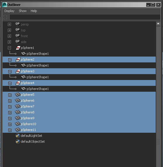

What you see on my screenshots - all these spheres were copied exactly as instances. So the spheres in my test scene - are instances of only one mesh shape object.
Perhaps there is some discrepancy in the terminology and you mean something else when saying "instances"?..
