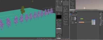

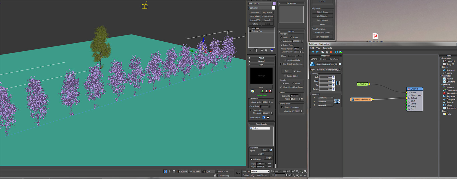

Using Ralclone Pro here and have to make some lines of trees.
But as soon as I switch to point cloud the trees do not render but they display in viewport.
The moveable Proxy doesnt work too because it exports all trees which takes very long if I use the display viewport as "Mesh".
Finally it doesn't show up materials. All trees are grey.
Can this be confirmed? Ususlly I don't have problems with RC.
Railclone not working with Octane (Point Cloud mode)
PURE3D Visualisierungen
Probably the geometry generated with all trees is exceeding Display->Limits. In this case you should use RailClone Tools to convert the items to instances, and turn on "Movable Proxy" to the result.
Regarding the material, please be sure the material assigned to RailClone (or the instances if you use RC Tools), is compatible with Octane. The plugin has not any special treatment for materials.
